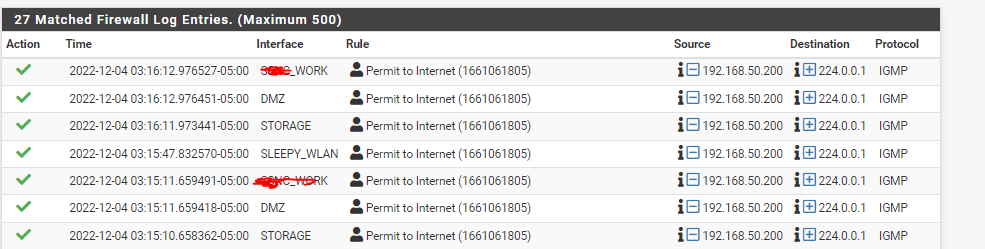

I have a firewall 'issue' but i need help in understanding what i am seeing here.
The screenshot below shows a Rule ID i am following '1661061805'. It is activated on several interfaces I have [DMZ , STORAGE, SLEEPY,WORK]. The obvious question is how is that possible? What is even more curious is the Source of the traffic - 192.168.50.200 - is a Unifi switch. At first my theory was that its sending out IGMP messages out each VLAN it has a trunk to. But after some thought that woulndt make sense as the Rule ID is the same.
Ive come across a similar issue once before which i documented in a previous post months ago but PFsense has an inconsistent habit of reusing the same Rule ID for multiple interfaces for different types of rules. Its random when it happens but its always if i create a new interface. This just isnt one of those times.

What is that rule? Is in on an interface group that contains all of those interfaces?
Check /tmp/rules.debug orpfctl -srDoes that switch exist on all those interfaces/vlans?

Not sure what you mean. The firewall does use a trunked interface going down to the switch for several vlans [SLEEPY,WORK]and there are some untagged vlans on separate interfaces on the firewall that go down to the switch [LAN] and [DMZ].
The topology is NetGate6100 ---> Unifi L2 switch ---> LANsWhat is interesting is that the only traffic type that this is capturing is IGMP. I would think that the Source IP would be blocked [192.168.50.200] as it appears on different interfaces with different L3 boundaries on the firewall

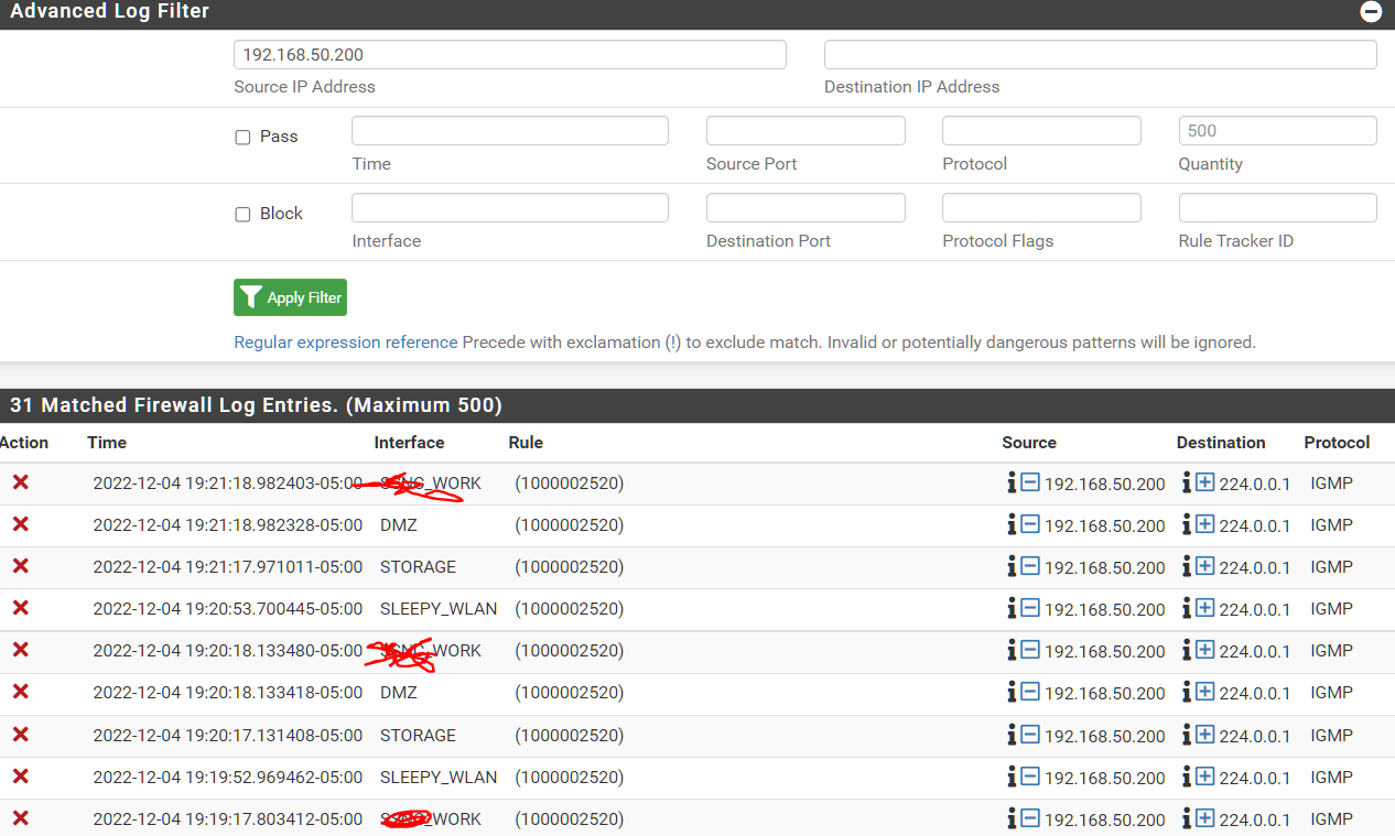

I ran the pfcts -sr command and now the output on the firewall logs are different -- traffic is getting blocked which you can tell is different from my original screenshot.
Right, the antispoof rule is what you'd expect to block that since that subnet is LAN and traffic is arriving on other interfaces.
That's not the rule that was passing it earlier.
I still wouldn't expect to see that traffic arriving on other interfaces though. It looks like either the switch is just sending it on all interfaces it has access to or it's leaking between them. But if it doesn't have access to STORAGE it may be something else.
@stephenw10 The rule passing was a rule for the IoT vlan i have.
/root: more /tmp/rules.debug | grep 1661061805
pass in log quick on $SLEEPY_WLAN inet from 192.168.14.0/24 to ! $RFC1918 ridentifier 1661061805 keep state label "USER_RULE: Permit to Internet" label "id:1661061805"Hard to say what the Unifi switch is doing as I have a Juniper switch that does not do this behavior. My guess is that the Unifi switch sends out IGMP Queries using its Management Address out each VLAN. Assuming that is true, why was the RuleID present on each Interface and permitting the traffic. Thats the bigger mystery and concern.
There no way that rule could have matched that so it has likely changed since then. The rule ID could have been referencing a different rule at that time.
Do you have any interface groups?Do you have the IGMP proxy enabled? Or UPnP?
I do not have Interface Groups.
I do not have IGMP proxy enabled.
I do have UPnP enabled only on one vlan and thats Sleepy(IoT) - 192.168.14.0/24 you see above.
Because of the anti-spoofing rule i agree the rule wouldve never matched so not sure why the firewall GUI was showing something completely different. -
The firewall logs pull up the rule description from the current running ruleset based on the identifier. But the ruleset that was running when that log entry was created may have been different. Thus what shows there as the 'Permit to Internet' rule may have been something different at the time. And that seems likely because there is no way that rule could have matched that traffic. Unless it was far more open previously.
However any single rule that could match all those entries would have to be something that applied to all interfaces. When you look at the ruleset directly that would be a rule without an interface specified.Steve
