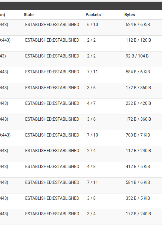

            In the states, I see the following with the proxy enabled.
              The brackets on those states make it look like they are NAT'd. The port forwards still active?
              I expect those states to be to HAProxy directly.
              All those states show two way traffic though so seeing 'host unreachable' looks like it may not be any of those.
