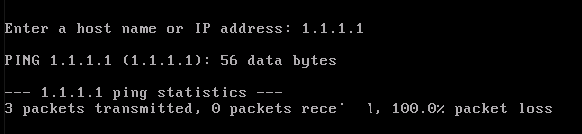

                    After it fails, via the console, there is no ping response from WAN or LAN IP addresses. WAN shows 100% packet loss. LAN shows:
