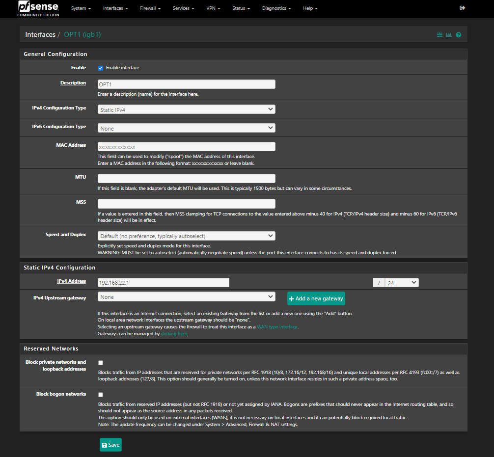

      1. I created & Enabled the new interface OPT1 Assigned Static IPV4 192.168.22.1/24 The main LAN is (192.168.55.1 Just FYI) - No additional settings enabled

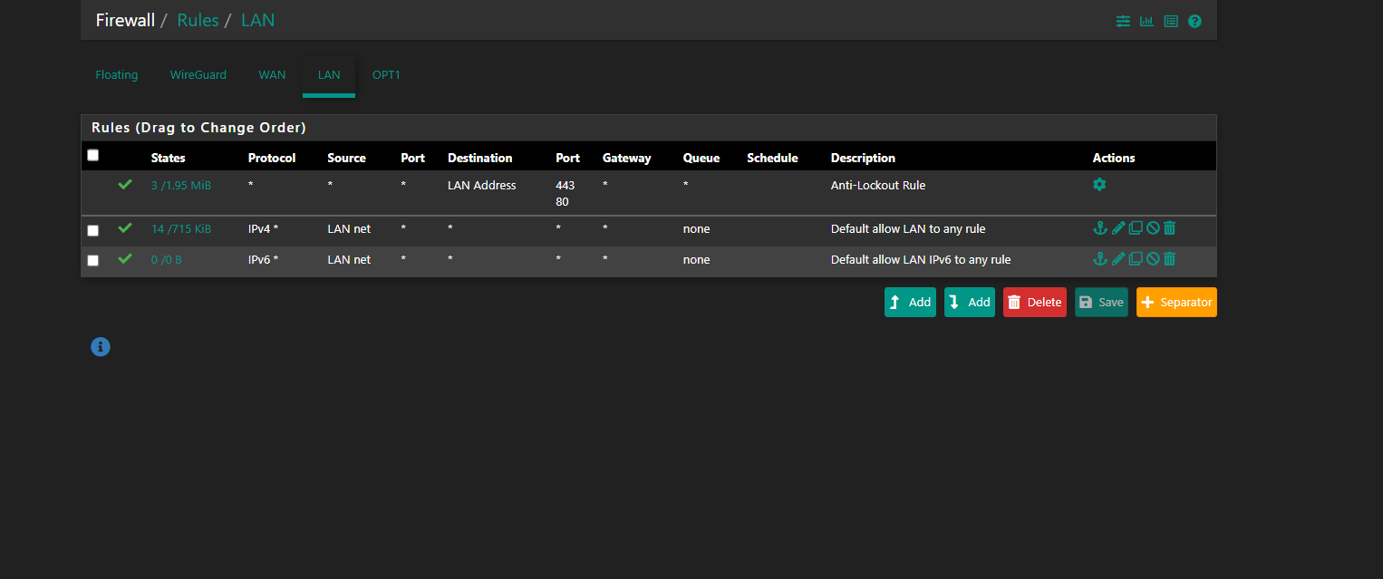

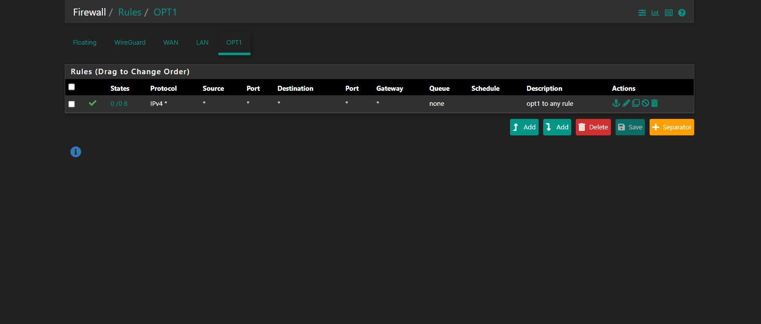

        @garric Explain number 2.
        Would also help to post pics of the firewall rules. Don't crop it to just the rules, post the whole page for each interface

          @jarhead You're right. See the attached. Thanks!!

            Jarhead @Garric
            @garric
            What exactly is the problem?
            Does the problem exist on the LAN also?
            There's nothing in pfSense that would block internet access on either network with this config.
            What are you checking with? a pc?
            Make sure it received it's config from the dhcp server. Maybe you had it set to static and didn't have the correct gateway on it?
            I'm just guessing but it could be anything.
