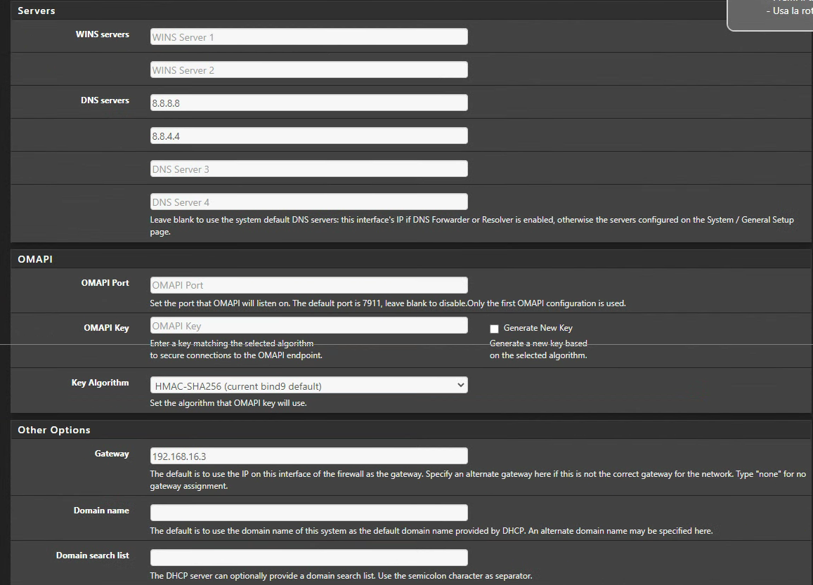

          another strange thing is that even if it set for the LAN interface this is actually forwarding all traffic from all interfaces (even VOIP interface are redirected to 192.168.8.230) i had to add
          192.168.16.0/24 to the DNS alias to prevent this from happening
          also
          with packet capture without pure nat >>>> services (voip.domainname.it etc etc) are being resolved from my dns but packets seems to stop at the network interface (LAN) or (WAN)
          so request voip.domainname.it-> dns 192.168.8.230 answer -> 192.168.16.180 -> request to 192.168.16.180 -> no answer and nothing on the VOIP interface with packet capture
          There must be something stupid i'm missing.

            Ensure that network settings on the device are correct, especially mask and gateway and that it does except access from the other subnet.
            NAT reflection does masquerading in the end. So the device will respond to an IP inside its subnet without the need of a gateway. And access from inside the subnet is often trusted by default, while outside access is blocked by the device's firewall.

              [root@centralino ~]# route -n
              Kernel IP routing table
              Destination     Gateway         Genmask         Flags Metric Ref    Use Iface
              0.0.0.0         192.168.16.3    0.0.0.0         UG    0      0        0 eth0
              169.254.0.0     0.0.0.0         255.255.0.0     U     1002   0        0 eth0
              192.168.16.0    0.0.0.0         255.255.255.0   U     0      0        0 eth0
              [root@centralino ~]# ip address
              1: lo: <LOOPBACK,UP,LOWER_UP> mtu 65536 qdisc noqueue state UNKNOWN group default qlen 1000
                  link/loopback 00:00:00:00:00:00 brd 00:00:00:00:00:00
                  inet 127.0.0.1/8 scope host lo
                     valid_lft forever preferred_lft forever
                  inet6 ::1/128 scope host
              2: eth0: <BROADCAST,MULTICAST,UP,LOWER_UP> mtu 1500 qdisc mq state UP group default qlen 1000
                  link/ether 00:0c:29:0d:d2:c0 brd ff:ff:ff:ff:ff:ff
                  inet 192.168.16.176/24 brd 192.168.16.255 scope global dynamic eth0
                     valid_lft 4759sec preferred_lft 4759sec
                  inet6 fe80::20c:29ff:fe0d:d2c0/64 scope link
              192.168.16.1 pfsense1
              192.168.16.2 pfsense2
              192.168.16.3 carp
