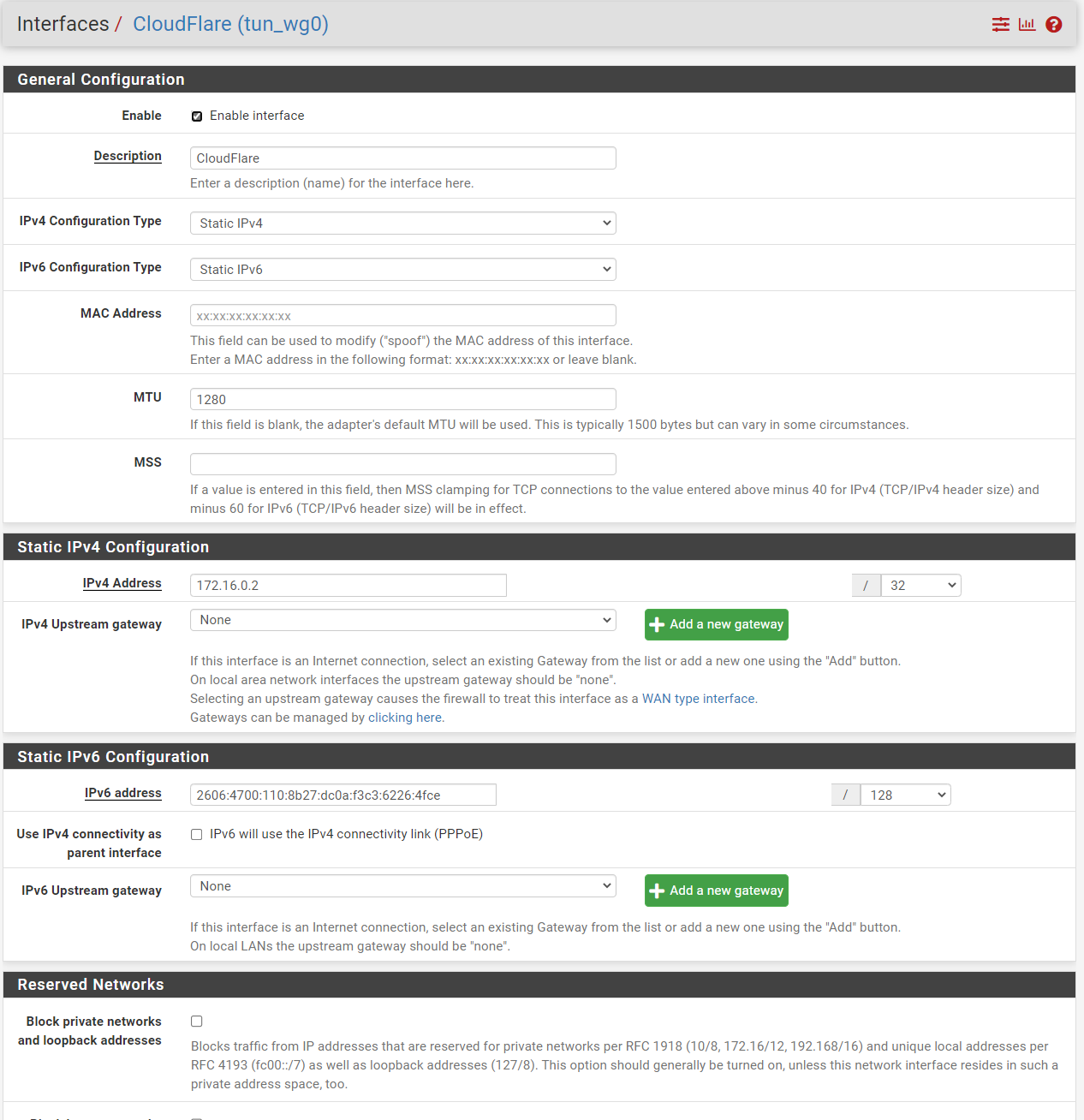

      So, i've setup Cloudflare WARP in WireGuard and all looks good.
      I can ping from the Cloudflare interface, and the ping is 100% successful. However, the TX/RX rate reads 0kb.
      Also, when change my NAT rules to route through this interface instead, I received no internet.

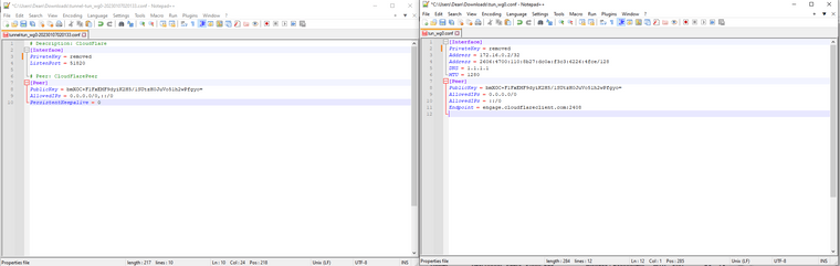

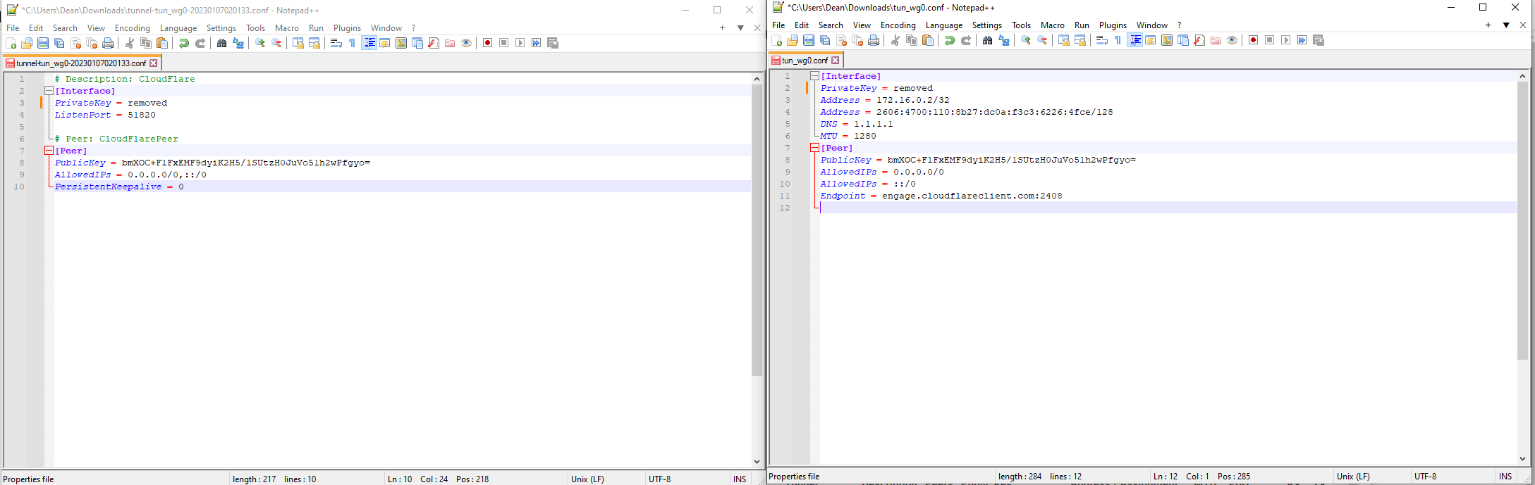

      For some reason, the configuration files dont match. The one is generated using WGCF from https://github.com/ViRb3/wgcf.
      I tried manually uploading the correctly generated config file and removing the old but it just changed back again.
      Screenshots attached below.
      Any ideas?
      It looks like the interface is up, just not sure if its reading 0kb as there is currently no traffic passing through it.
      Thanks

        It's showing it's never completed a handshake so that is not up correctly. You must have a mismatch there somewhere.
        I suspect your ping test was not actually using the WG tunnel.
