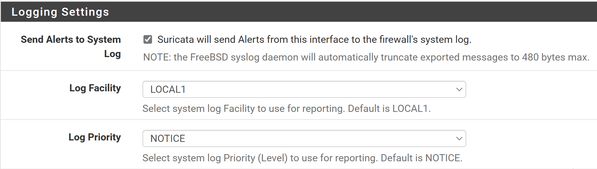

        Have you checked the box on the INTERFACE SETTINGS page for the Suricata instance that says Send Alerts to System Log?
        That will send the timestamp of the alert and some basic information about which rule triggered and what the IP addresses and ports were. But FreeBSD has a hard limit on the payload packet size for syslog data sent to remote systems. If I recall, that limit is 512 bytes. Anything beyond that limit is truncated and not sent over the remote syslog connection. But even with that limit, you should be able to get all the basic alert info. You obviously cannot send packet payload data over that connection, though - a least not all of it.

          jpgpi250 @bmeeks
          @bmeeks
          as you can see, I updated the settings, indicated in your reply
          The configuration change is noticed and logged in the system log (third screenshot)
          I than ran a dig that triggers a suricata alert entry (22:15:03), but nothing appears in the system log.
          tried to restart the system logging ( /etc/rc.d/syslogd restart), same result, nothing in the system log.
          tried several other combinations (localx - syslog and warning) but no joy.
          1 Reply Last reply
