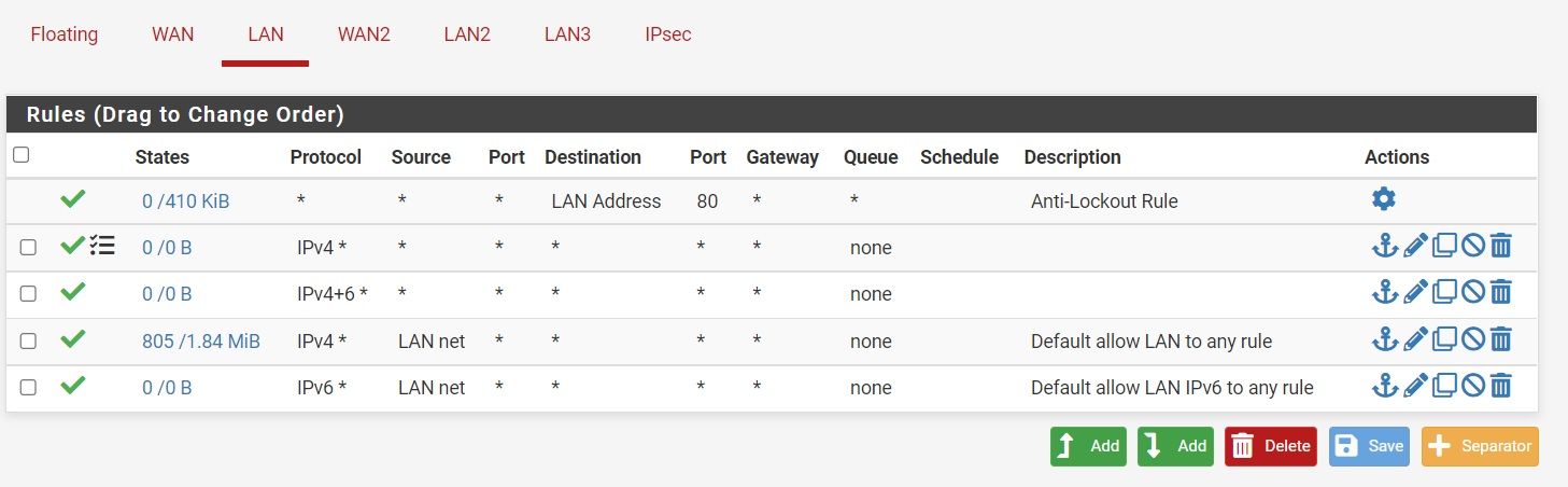

      I also doubled checked the GW and Default routes and it has a 0.0.0.0/32 pointing to 192.168.1.1. And I have also turned off "Block Private Networks and Loopback Addresses".
      I've got Any Any Firewall rules for both LAN and WAN just to rule that out. Will be fixed later.

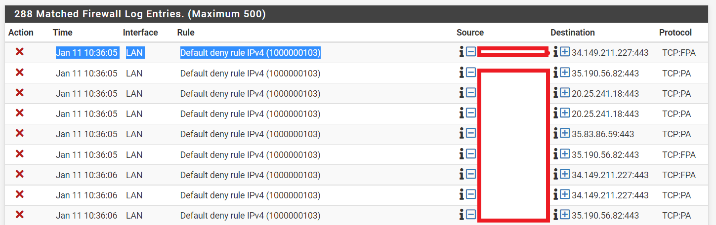

                      I'm at the site and went over the config again, everything looks good until I went into the firewall logs and saw this block coming from my address.
                      Jan 11 10:36:05 LAN Default deny rule IPv4 (1000000103)
                      That's really strange because I have a Top Level 'Any Any' Rule on the LAN Interface so nothing should be getting blocked.
                      It's also blocking Locals on WAN despite having that turned off.
                      • P Offline
                        photomankc
                        Those blocks with PA and FPA look like some type of traffic that got sent after the firewall had already closed the stateful connection out in its table. It happens sometimes. Or maybe a connection that was dormant too long and the state entry timed out. Probably not really a blocked connection.
                          Those are all TCP ACK packets so they are blocked either because the state has already closed or because you have some asymmetric routing:
                          https://docs.netgate.com/pfsense/en/latest/troubleshooting/log-filter-blocked.html
