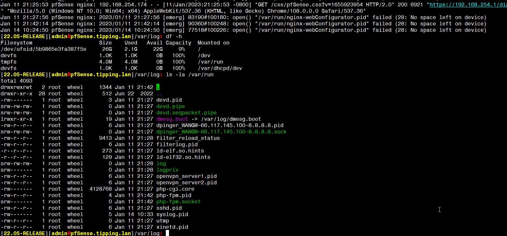

        • B
          bazzacad @stephenw10
          @stephenw10 Thanks for the reply. I was able to get back into the GUI now. But I think I still have issues. From the nginx.log, I found that nginx was failing because /var/run was full.

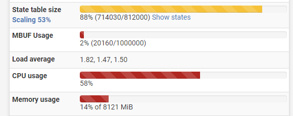

          I moved the large php-cgi.core to the /tmp folder & then rebooted again & I was able to get back into the GUI. But /dev & /var/dhcp/dev are still 100% full after the reboot.
          And now the state table size & CPU usage seem really high & no one is logged in right now.

            • B
              bazzacad @SteveITS
              @steveits Thanks again, after posting & looking at the states some more, I realized I had a network monitoring service running in the background on my workstation. I've now turned that off & the states are now back to 0%-1%.

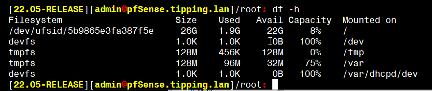

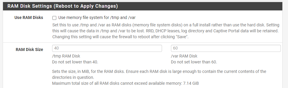

                • B
                  bazzacad @SteveITS
                  @steveits Here is what I have, I think this was the default.
                  B SteveITSS 2 Replies Last reply
                  Reply Quote 0
                  • B
                    bazzacad @bazzacad
                    OK I've changed them to 1GB. now

                    • SteveITSS
                      SteveITS Galactic Empire @bazzacad
                      @bazzacad Off is the default. You might try to find another df -h on the forums. All I was saying was 4 MB seemed odd but I donโ€™t have a comparison.

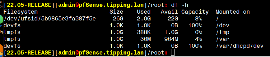

                        • B
                          @stephenw10 Hmmm, I decreased /var to 128MB, and it's already 75% full again. How can I turn off the RAM disk, but still adjust the size of /var?
                          SteveITSS 1 Reply Last reply
                          Reply Quote 0
                          • SteveITSS
                            @bazzacad /var is not normally set separately, except apparently /var/run. You can just uncheck the "use RAM disks" option above to not use a RAM disk. Otherwise you have to set a size, and it needs to be big enough for whatever pfSense needs, which will vary by logging and package usage.
