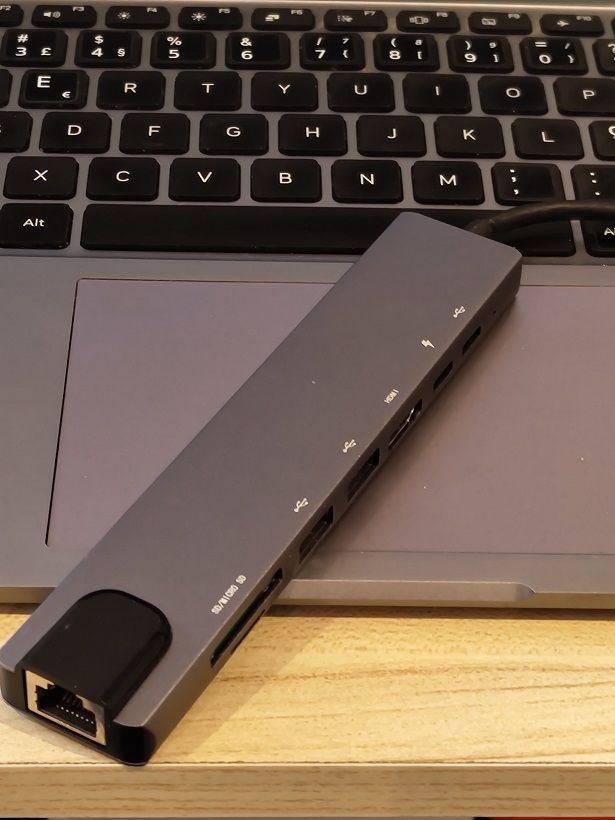

                I think I will buy a new NIC because the one I got (see image) is not detected or pfsense doesn't have the appropriate drivers.
                Do you know what NIC should I buy (to be plugged on USB) that will be plug & play with pFsense?
                Thanks.

                    @pgomes2000 USB nics are really not the way to go but if you search the forum you can find ones that work.
                    You're really better off buying a vlan capable switch and going that route. Probably cost the same.
