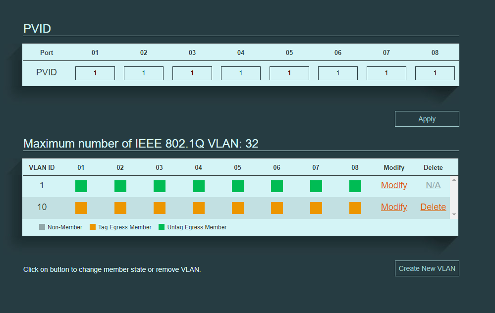

            • O
              okarin001 @stephenw10
              @stephenw10 Thanks, I am still learning networking and I was wondering how I should configure this. Forgive me.
              VLAN 1 is default and DMZ is VLAN 10. My plan is use :
              Port 1: Uplink from firewall
              Port 2 to 7 LAN devices
              Port 8: Hypervisor with couple VMs LAN and that one DMZ machine.
              I put picure here from Switch WebGUI.
              1 Reply Last reply
              Reply Quote 0
              • stephenw10S
                VLAN10 only needs to have ports 1 and 8 as members if you don't need to have DMZ hosts anywhere except as VMs. Otherwise that will work for the switch config.
