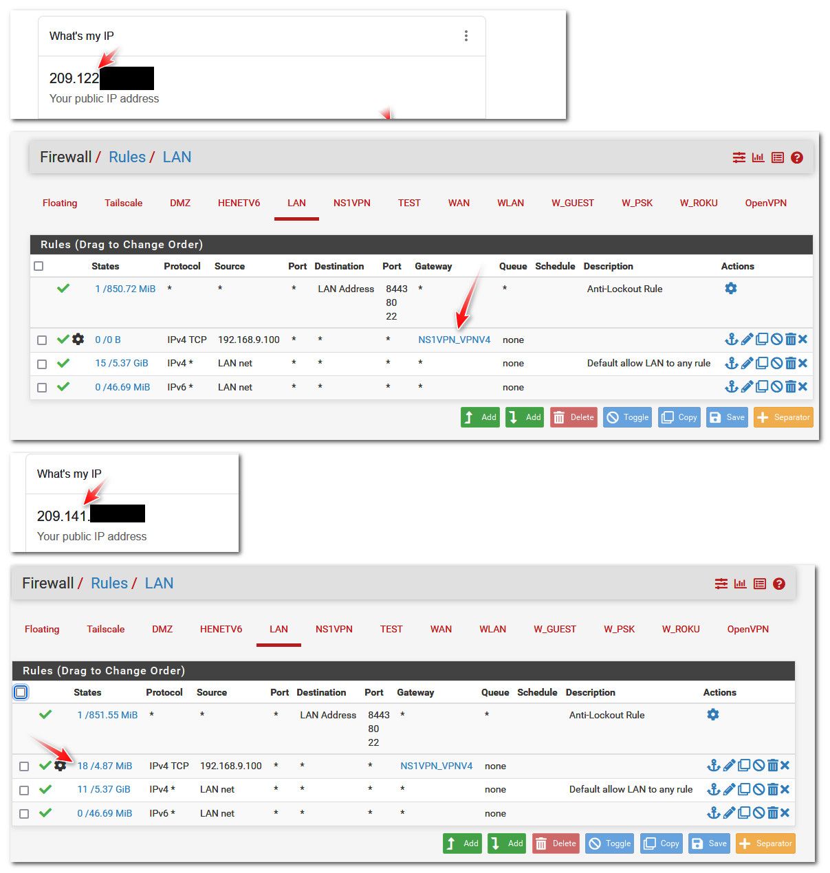

                    johnpoz LAYER 8 Global Moderator @zaffy
                    @zaffy you don't have to actually put the tv in a different network/vlan to use policy routing. You can route a specific IP out a vpn via policy route rule with just one lan network..
                    Example:
                    So my normal IP when going just out my normal ISP connection. Funny that same first octet ;) Then create a policy route for my PC IP, killed all the states for my pc so new connections use the new policy route. And see that my IP is now the IP of my vpn connection.
                    Notice in the rule as well that you see traffic and states using the policy route rule the 18/4.87 MB
                    SG-4860 26.07 | Lab VMs 2.9.1, 26.07.1
                    NogBadTheBadN Z 2 Replies Last reply
                    Reply Quote 2
