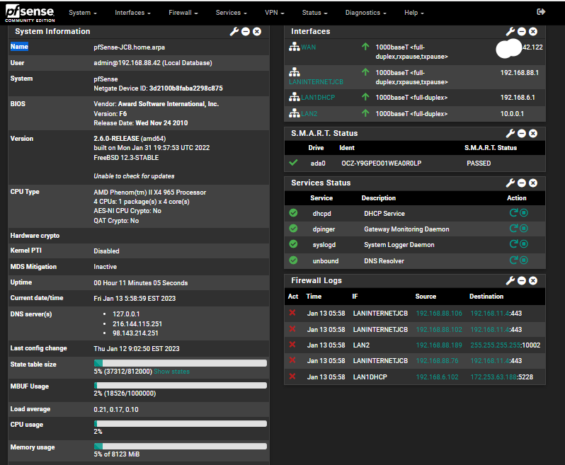

      I've been managing a small WISP network for familly and neighbors since we could get no better than bad satellite internet.
      My knowledge base is limited. I mainly used ubiquiti products and I mostly copy/paste configurations.
      I was worried my edgerouter4 was no longer cutting it, I disabled some functions to ease its load but now I'm ready to try something else.
      I reassembled my old pc, got an overkill intel 10gb NIC and installed pfsense.

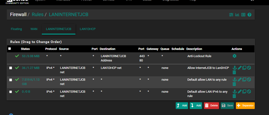

      I tried to copy the subnets of my edgerouter4 and added firewall rules for my server.
      I have good internet access when only my laptop is connected to the pfsense router but as soon as I plug the rest of the network to it, internet gets “sort of mostly blocked” and, it seems, by the firewall log, default deny rule is blocking port 443 when it shouldn't. Any to any rules are in place on the lans so that confuses me. Then randomly, a page loads.
      Most of the wisp hardware is on subnets 192.168.88.0/23 192.168.11.0/24 10.0.0.0/24. They are on the same interface via ip aliases.
      DHCP is running on a different interface on subnet 192.168.6.0/23 and I want the clients to access internet, the router(for my convenience) and my server.
      WAN is set to DHCP and properly gets an IP
      I tried resetting states and rebooting the brocade switch it is connected to.
      PFsense is version 2.6.0
      Here's a few snaps of my config:

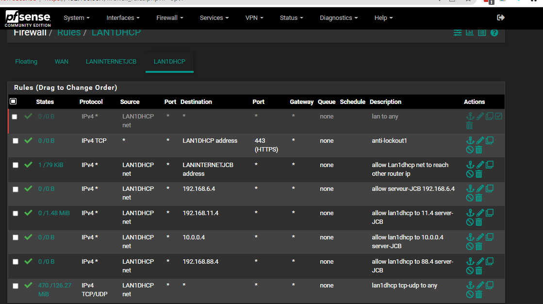

      326166686_1586398091840544_8451659438434042221_n.png 325638036_850704132887980_6061177843029661755_n.png 325636861_5756030501170617_8203796277781370931_n.png 325545776_498135415806586_4906803783055764946_n.png 325519915_579187787553389_4827384715193926011_n.png 324373860_3172442946239445_4127195296790073717_n.png 323534567_882554146204208_8019783831322378281_n.png 318152441_1166284560696262_5409392614743166810_n.png

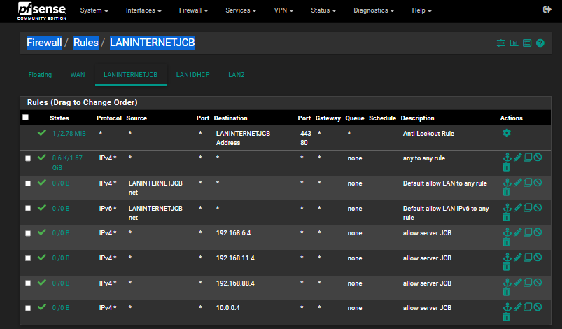

      As can be shown, I tried adding some redundant any to any rules.
      Can someone tell what is wrong with my setup from this?

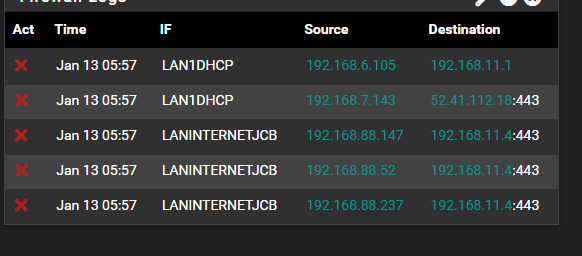

        @sphex where is this 192.168.11 network - not seeing it on your interfaces?
        Are you using a larger than /24 mask - I see a 192.168.6.1 on your landhcp interface..
        Are these blocks your seeing to 11.4:443 Syn or SA, or something other than SYN?
        If your mask on your 192.168.6 interface also includes 192.168.11 then those rules are pretty pointless on your lan dhcp interface allowing traffic allowing access to 6.4 and 11.4 - traffic on the same network would never talk to pfsense. Pfsense is a router to get off a network.. But since I see hits on the 11.4 rule - that would tell me atleast your client doesn't think 11.4 is on the same network?

          192.168.88.0/23 192.168.11.0/24 10.0.0.0/24. They are on the same interface via ip aliases. Or should be anyway. I configured them in the virtual ip menu.
          192.168.6.0/23 is on landhcp interface
          Likely, most of the ubiquiti wisp hardware is pinging and reporting to the server on 11.4:443 or x.x.x.4, that is around 300 devices. Now I think most are on x.x.88.x/23 subnets. I had been moving them to eventually delete the 192.168.11.0/24 subnet. I don't know all the protocols they use but I think I want them to work.
          johnpozJ 1 Reply Last reply

            @sphex said in New setup, first time user:
            well that is not a good setup at all.. Different networks should be setup with vlans, or multiple physical interfaces - running multiple layer 3 on the same layer 2 is not good idea..
            But those blocks your seeing to 11.4:443 are they syn blocks or some other flags, like SA, A or FA, R etc..
            S 1 Reply Last reply

              @johnpoz said in New setup, first time user:
              I don't know what that is or how to tell what it is.

                @sphex look at the full firewall log vs just the widget

                  @sphex I'm not that familiar with WISP but by "WISP hardware" is that how the connection is made to the Internet? I'm not really clear why that would not be on WAN and why it would need multiple subnets but I may just be not understanding. I'm asking because the clients on LAN1DHCP would not go through the LANINTERNETJCB network to get out to the Internet, which might cause asymmetric routing.
                  Your four "allow server JCB" rules will never trigger because of the two LANINTERNETJCB files allowing all traffic, which will also not trigger because of the "any to any rule" which I'm guessing is temporary.
                  pfSense will block stray/extra/resent packets if the state is closed. See https://docs.netgate.com/pfsense/en/latest/troubleshooting/log-filter-blocked.html There's a picture on that page, see the Protocol column in the block log for the type of block.

                    ^ exactly - if the block is not a SYN (S) then it points to out of state for the reason for the block, vs any sort of firewall rule not allowing it.

                      They are marked (A)

                        If they are all ACK packets that looks like an asymmetric route.
                        I also notice pfSense shows it;s unable to check for updates.
                        With a DHCP WAN and only one gateway it should always have a correct default route so I would check for DNS issues.

                          Yes my firewall rules are redundant. I tried something...

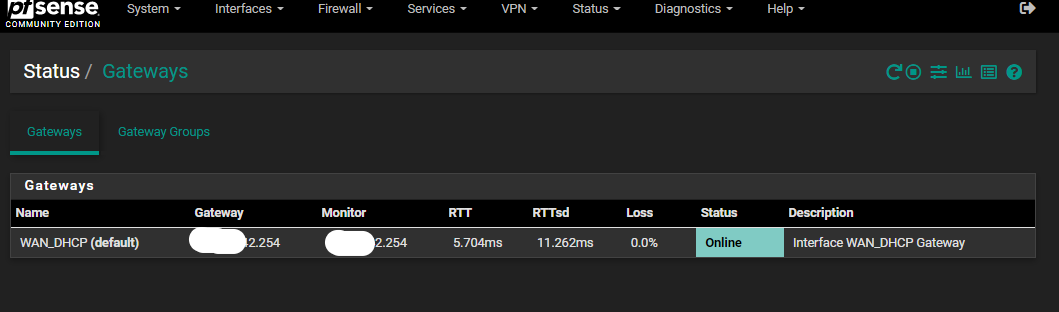

                                    I still lose internet when I plug the 300+ devices network(192.168.88.0/23) to the pfsense router.
                                    I am convinced it is because of my ISP. Gateway status is marked as down (or something, I didn't take a snapshot) with latency above 3 seconds.
                                    My current edgerouter4 is configured with load-balance with another (slower) provider and I had to set the route-test failure count to 60 so that it wouldn't drop the connection during rush hour.(for the problematic ISP only)
                                    That old setup works*, MTR test results are ugly, smart TVs say they are disconnected every 5 min but VoIP works fine, gaming and streaming is fine.
                                    Because the pfsense router isn't setup in load-balance, I didn't think it would drop the WAN connection if latency was too bad. How can I tell if that is the case and can I adjust/disable the fail-route test of the pfsense router?
                                      if pfsense believes its gateway is down - then yeah not going to work.. if its not really down you can set it to be considered always up..

                                        If your ISP has massive buffer-bloat you're going to see large latency increases when traffic increases however powerful your router is. To actually address that you need to use some traffic shaping on the firewall.
                                        If you only have one gateway defined it will always be the default route and pfSense will always try to use it. However it will still trigger a bunch of scripts that aren't required if you only have one. So I'd recommend editing the gateway and setting 'Disable Gateway Monitoring Action' to prevent that. However if you move the load-balancing over to it you will need to re-enable it.
                                        Where do you lose internet access from when you connect the 192.168.88.0/23 devices? What are you actually doing to connect them?
