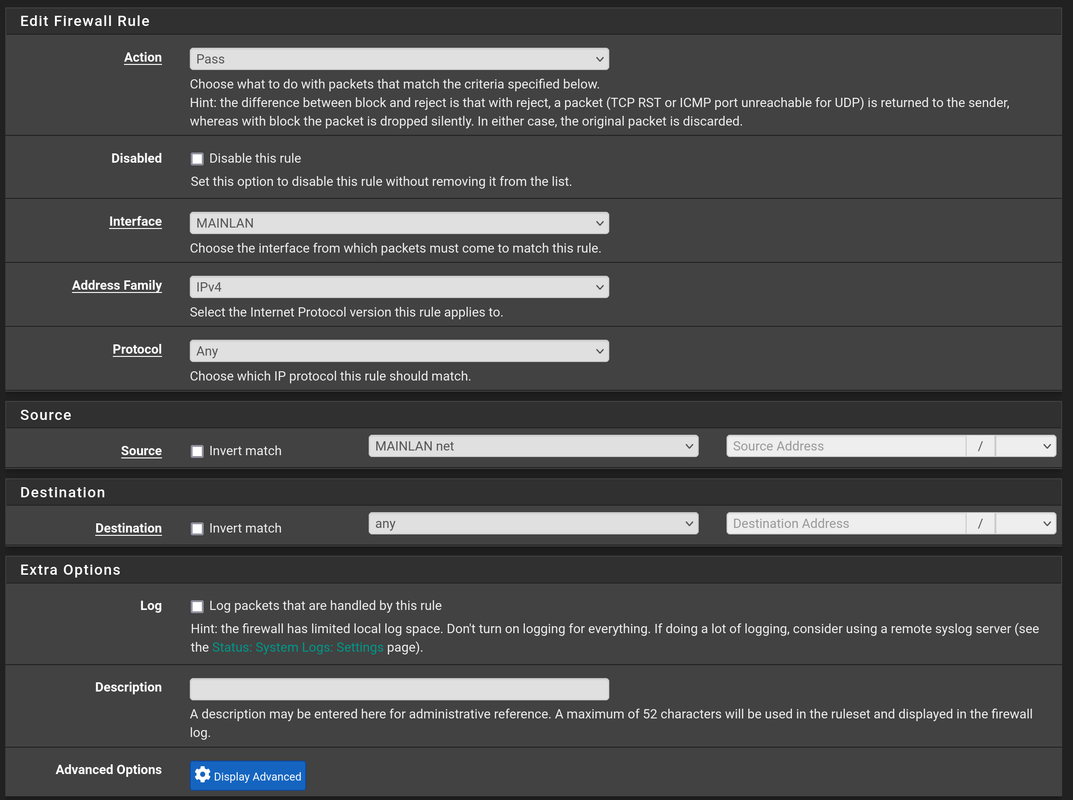

          alt text
          I think this should allow for everything?
