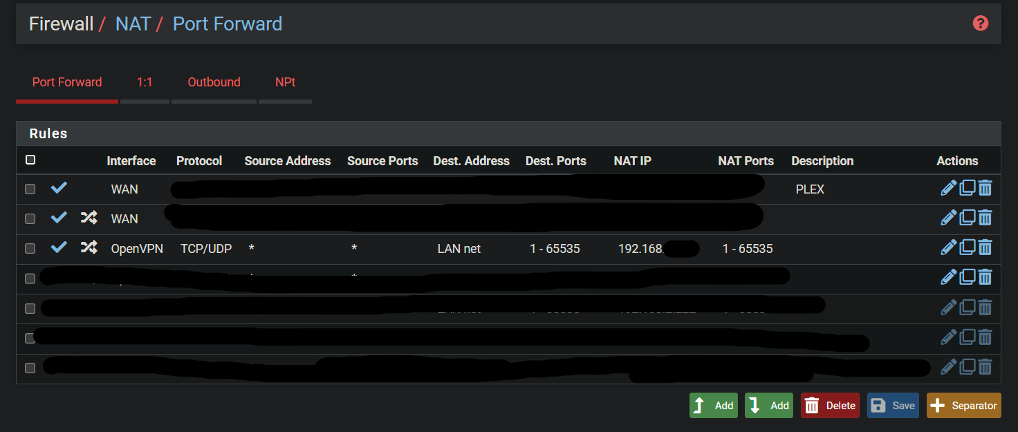

          Hmmm, not sure exactly. I used the setup wizard
          This is what the NAT PF looks like (sorry for the redacted content, don't know what needs to be kept a secret. It's basically ports for torrents and plex and things that are disabled right now but used for testing)

            I meant any outbound NAT rules you might have on LAN for traffic coming from OpenVPN.
            However that port forward looks wrong. That's going to be catching all traffic coming over the VPN with a destination of any host on the LAN subnet and forwarding all of it to whatever host you have set there for the NAT IP. So that's probably the cause, disable that rule.
            You don't need a port forward to access the LAN from the OpenVPN tunnel subnet it should be all routed directly. You only need a firewall rule on the OpenVPN interface. And the hosts on LAN themselves need to allow connections from the tunnel subnet.

              Hey Steve! That worked. I honestly don't remember setting that up. I thought it came through with the OpenVPN wizard. Thanks for all the pointers. I clearly have lots to learn.
