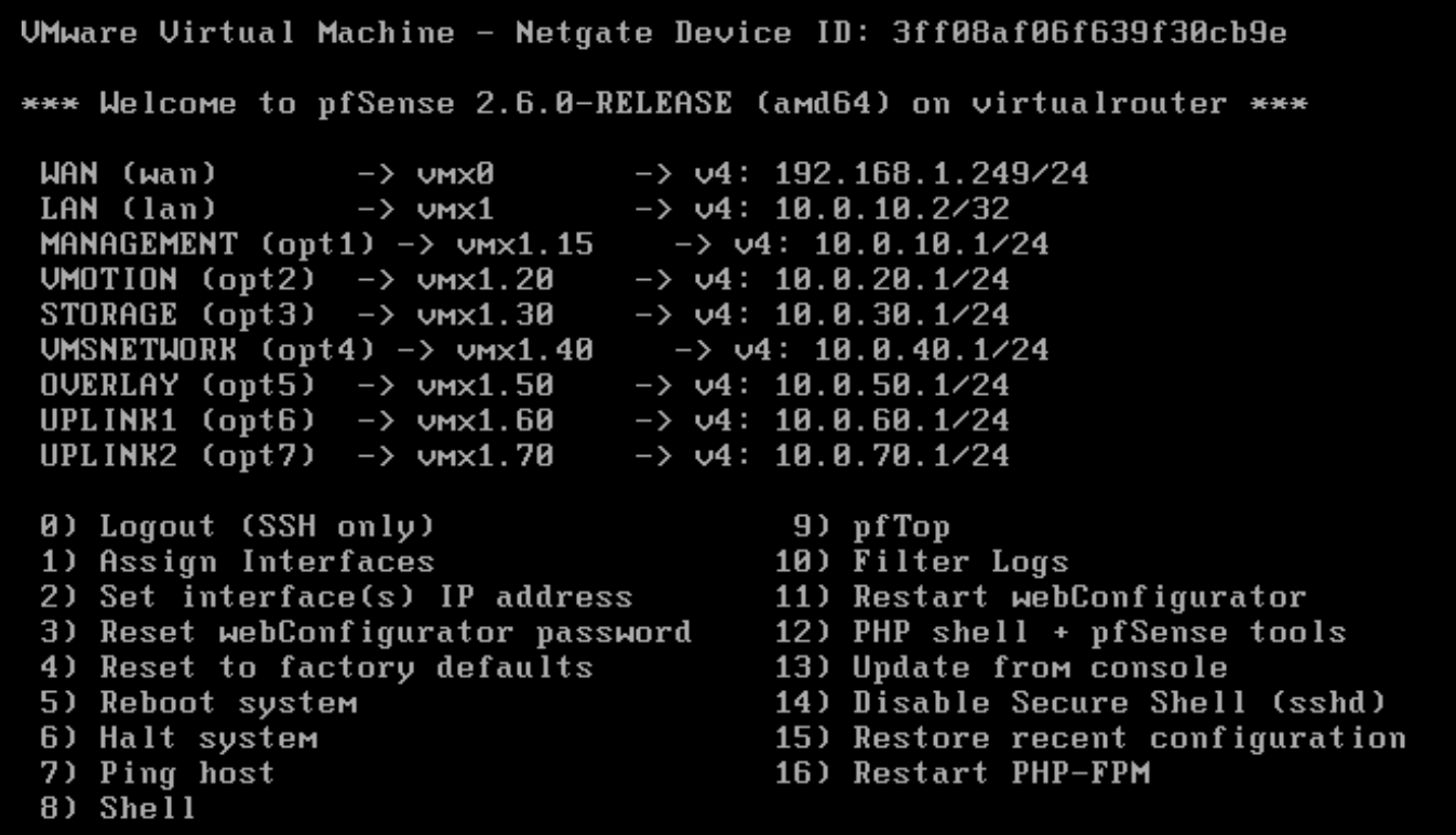

              Full configuration:
              Have vmxo - WAN with: 192.168.1.x (with IP from the internet router) with the gateway pointing to my internet router
              vmx1 - LAN with:10.0.10.2/32 - no VLAN added
              Then I have 7 VLANs
              1 - 10.0.10.1/24
              2 - 10.0.20.1/24
              3 - 10.0.30.1/24
              4 - 10.0.40.1/24
              5 - 10.0.50.1/24
              6 - 10.0.60.1/24
              7 - 10.0.70.1/24
              All VLANs are assigned to the vmx1 LAN as parent interface. So I have vmx1.10, vmx1.20, vmx1.30, etc.
              @Jarhead, there is no gateway on any of the LAN, only WAN as a gateway and is the IP of my internet router.
              As I said, the internal local network is working ok. All VMs can reach each other(using the network 10.0.10.1/24, which also has DHCP from 10.0.10.10 to 10.0.10.150), and the gateway on those VMs is always the VLAN IP, in this case, 10.0.10.1.
              So if VMS has an IP eq: 10.0.10.100 and has the gateway 10.0.10.1 cannot reach the internet. That is my problem here.
              Is the problem because I am using the vmx1 LAN with no VLAN and IP 10.0.10.2?
              Thanks again for the anwers.
              SE

                Just another update that could also be important. Inside of all my network(and switch), only the 192.168.1.x(local network) and 192.168.10.x(storage network) subnets is available and works.
                In the Switch, I only use two ports where I added/trunk all the VLANs used on the pfsense, which are the ports connected to the pfsense LANs.
                Don't know if this is important or not.
                But I added all the VLANs IP subnets to my switch.
                J 2 Replies Last reply Reply Quote 0

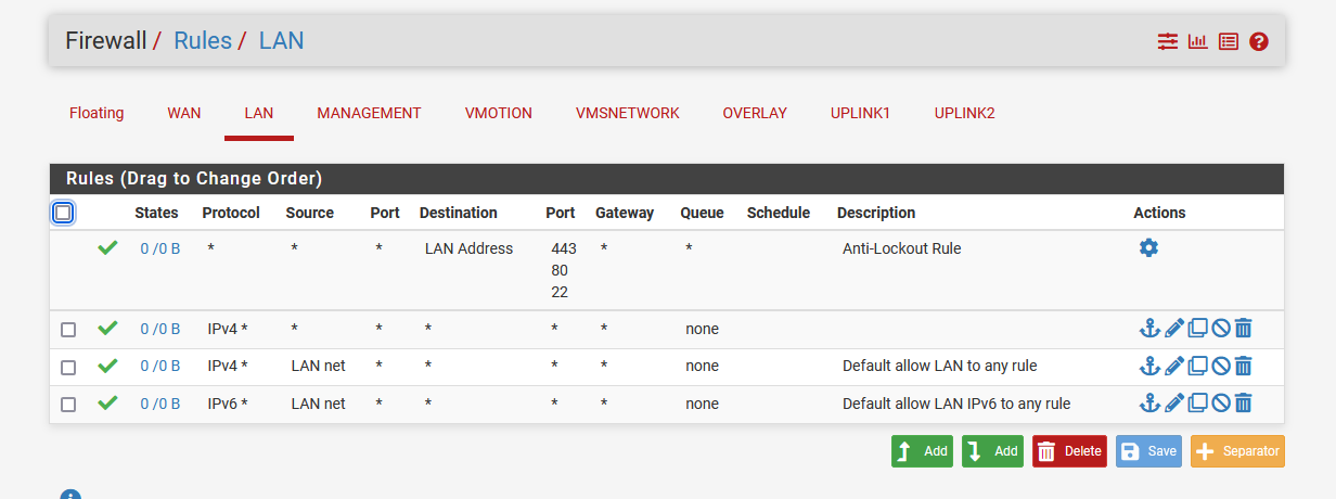

                              johnpoz LAYER 8 Global Moderator @StoneEdge
                              @stoneedge said in Get internet on one LAN interface:
                              Yes VMs can ping each other and also the 10.0.10.1.
                              well what are the rules on this interface then... Did you mess with outbound nat on pfsense. If client can talk to the pfsense interface, and the rules allow it - it would have internet, if pfsense has internet. Unless outbound nat was wrong.
                              Or your rules on the interface are not allowing for dns that the client is using? So when you do a traceroute to say 8.8.8.8 what happens? you hit 10.0.10.1 as your first hop and then nothing?
                                      @stoneedge if you have no rules on pfsense interface you wouldn't be able to ping it from that network.. If pfsense IP is 10.0.10.1 and you have no rules on the interface.. Then no you wouldn't be even able to ping it from 10.0.10.x - either you have rules on that interface allowing ping. Or you pinging something else and not pfsense.. If there are no rules on the interface to allow ping, you wouldn't be able to ping it..
                                        StoneEdge @johnpoz
                                        @johnpoz these are the settings
                                        I have 3 VMs.
                                        One with IP 10.0.10.3 (a DNS and DC)
                                        Another is with DHCP 10.0.10.100 (DHCP is enabled on the LAN vmx1.15)
                                        Another as a jump host 10.0.10.11
                                        All VMs are windows and all have in windows interface (VMware vmxnet3 virtual network) set trunk the VLAN 15.
                                        And again, I can ping all IPs on the subnet 10.0.10.x(except the 10.0.10.2) from any of those VMs.
                                        Regarding the rules, sorry my previous statement was wrong. I have the default rules.

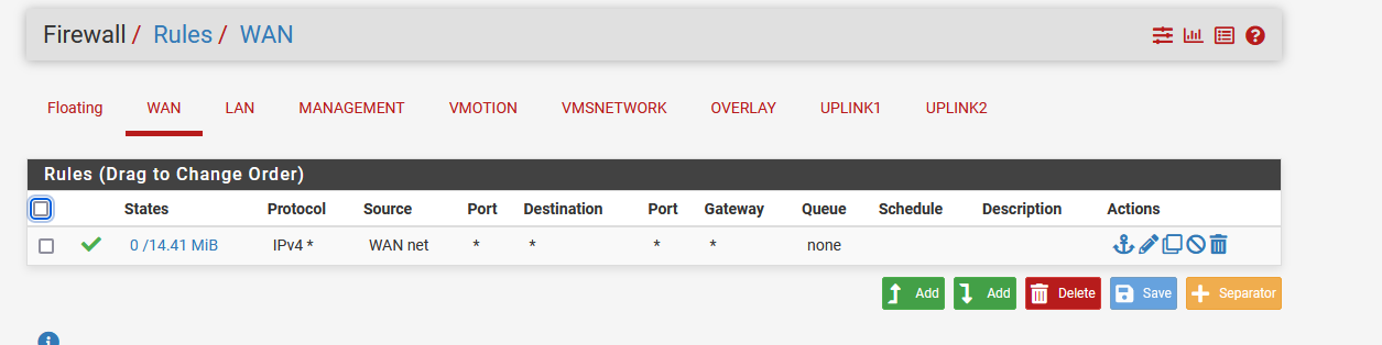

                                          @stoneedge what rules do you have on the vlan interfaces? When you create a new interface/vlan there will be no rules. Are you saying you have a any any rule with the vlan as the source net for ipv4 any?
                                          Also generally speaking a any rule on your wan like that is a really bad idea!!
                                          Is anything even talking to pfsense? your rules on your lan all show zero evaluations - those 0/0 under the states table mean none of those rules have ever triggered.
                                            StoneEdge @johnpoz
                                            @johnpoz honestly do not know what is impacting the configuration here.
                                            But one thing is for sure, I am pinging this 10.0.10.1. Because if I disable it, ping doesn't work anymore.
                                            Regarding the WAN, that is no problem here. This is my homelab, so firewall rules and security is not something that is to worry about much :)
