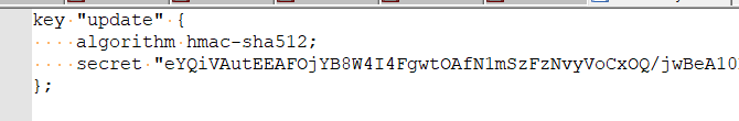

            Gertjan @regexaurus
            @regexaurus
            RFC2136 : using TSIG : the key name is mandatory here.
            Example : when I generated a "TSIG key" at the server side (I'm using the domain name server bind), I get this :
            so my key is "update".
            edit : if possible, look at the transaction logs 'at the other side'.
