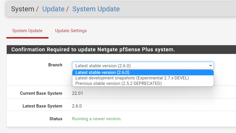

              FYI, screenshot of the update screen
                Hmm, well it hasn't completed the upgrade correctly. There is a mix of 22.01 and 2.6 pkgs there.
                Really it would be better to reinstall 2.6 clean and re-upgrade.
                However you might be able to force install the 22.01 pfSense-repo pkg:
                pkg add -f https://firmware-atx.netgate.com/pkg/pfSense_plus-v22_01_amd64-pfSense_plus_v22_01/All/pfSense-repo-22.01_5.pkg
                Then select the 22.01 branch and upgrade any remaining packages.
