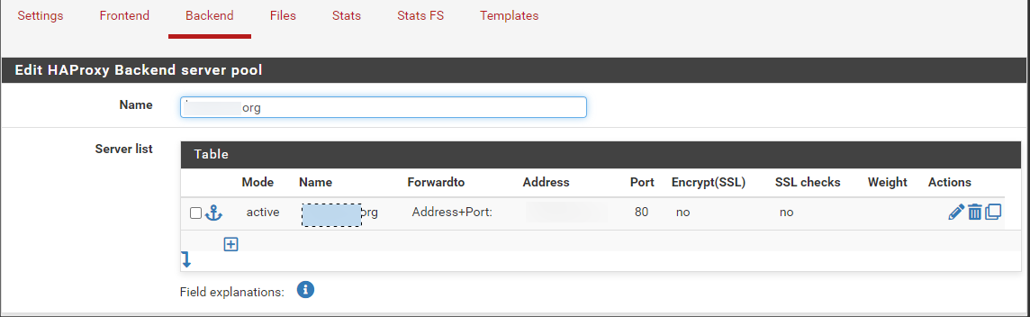

      backend xyz.org listens on port 80
      the configuration is pretty simple:
      the only other change on the backend I did is the help check version: HTTP/1.1\r\nHost:\ xyz.org

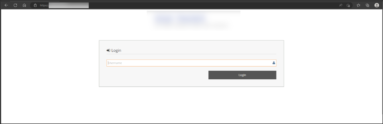

      When you browse the webpage without haproxy this is how the page should look like:
      When I browse to the page on HTTP using the PfSense HAProxy I get the same results.

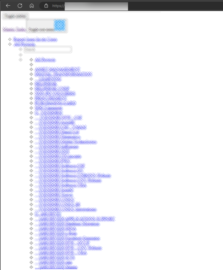

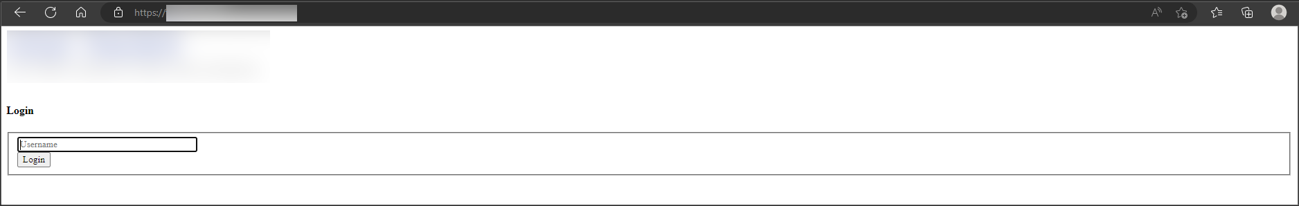

      The problem comes when I use HTTPS then the page format changes, for example, the login page:
      It seems like the rendering of the page is not coming up exactly as it should. Note the login page and the design differences.
      Once I log in to the page that's where I have the problem. It seems as if some of the design/css files were not loaded at all.
