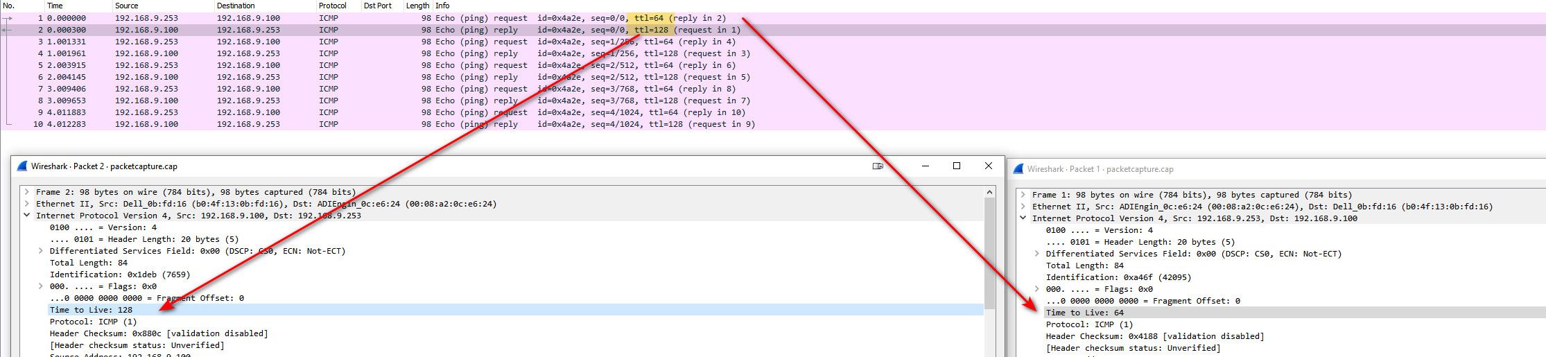

      Hello,
      Is anybody can tell me why the TTL decreased when I pinging a local adapter in PFSense?
      Where is the hop in this traffic? (I try to define the local adapter as source, same)
      If I pinging an another host IP, the ttl is normal (-1 hop)
      (see pictures)
      Thanks,
        johnpoz LAYER 8 Global Moderator @ierdelyi
        @ierdelyi that would related to the default ttl. Different OSes or different use cases might use a different default ttl.
        The default ttl for freebsd is 64
        [22.05-RELEASE][admin@sg4860.local.lan]/root: sysctl net.inet.ip.ttl
        net.inet.ip.ttl: 64
        But where your pinging might have different, and it sends back different ttl in the response
        Now look when do it the other way from my windows machine that uses a 128 default ttl
        9.100 is my windows machine, and 9.253 is pfsense.
        So for example pinging my nas that is on the same network as my pc, its default ttl is like pfsense 64, since its running a linux based OS.

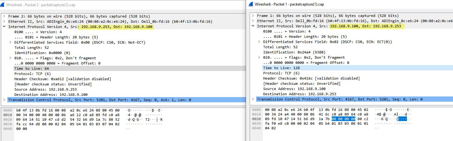

            @ierdelyi glad I could be of help - yeah a ttl would be from the sender of the traffic.. So for example same goes with a tcp connection.. See how windows uses a 128 ttl, and freebsd (pfsense) uses a 64. If I make a tcp connection, the ttl that comes back is what the destination box sends..
            Notice here is a iperf connection to pfsense... Notice windows sends 128, but pfsense sends a 64 in the response..
            So in the syn, from 9.100 to 9.253 port 5201 the ttl is 128, but in the syn,ack pfsense sends back the ttl is 64
