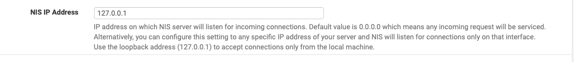

                    jrey @stephenw10
                    Not saying I know this is related, however I noticed the OP is running on the "default" setting stating
                    Running: apcaccess -h 0.0.0.0:3551
                    where as I am running on the more "focused" setting of
                    Running: apcaccess -h 127.0.0.1:3551
                    per the setting / description here:
                    No issue here that I have noticed. But it is also possible this unit hasn't had a transfer to battery in the past couple of days. There has been a system reboot (normal reboot cycle via the diag menu).
                    JR
