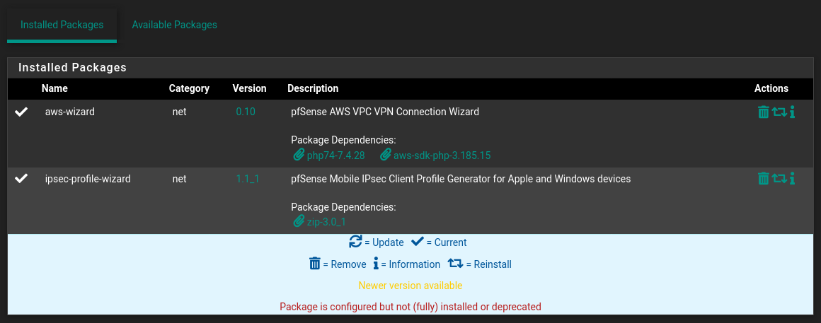

      My working theory is that something about this file, likely the particular section listed above, is tripping a DPI trigger for a potential attack. Though the rub and where the case has gone cold is currently I am not running any kind of applications on my Netgate 2100 that to my knowledge do DPI. For reference here are all the packages on my Firewall:
      From my knowledge neither of these do any form of DPI that could block this kind of traffic nor am I aware of any pfSense native features that do this kind of filtering. I am aware of packages such as SNORT and Suricada that could do this, but they are obviously not installed.
