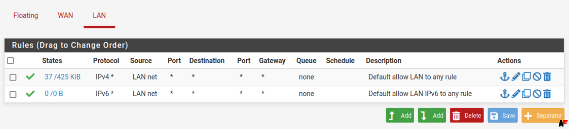

I found that this is only true from the VMs, i.e. within the network, maybe I am doing something wrong in the pfsense firewall for the local network, I don't know right away, everything are still at default.
And if I turn those rules off, I get no response to curls.

Where exactly are you testing from?
What does mydomain resolve to?
I'm testing in a VM on the same network as the web server and the mydomain resolves the public ip address of the physical interface. -
@jobbedf said in No LAN connections:
The external Proxmox NIC? So not the pfSense WAN?
In that case NAT-reflection wouldn't work directly because the port forward would be from the pfSense WAN IP to the VM behind it not the public IP so would not match outbound traffic to it.
It's better to use split-DNS anyway though which would work fine here.
Yes right, the Proxmox NIC.It can be correct because due to NAT reflection, only LAN access now works and not from my own browser.
But does split-DNS work if I have already forwarded port 53?
Forwarded it from where to where?
If you're testing from a VM behind pfSense and that VM is using pfSense for DNS then adding host override there will work.
