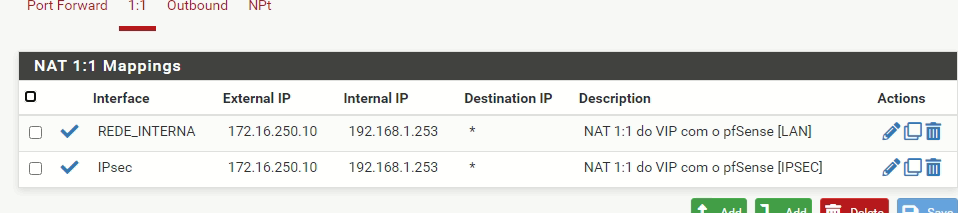

      I created a NAT 1:1 both on LAN interface and IPSec interface which says:
      External IP 172.16.250.10 (VIP...)
      Internal IP 192.192.168.1.253 (Actual pfSense IP)

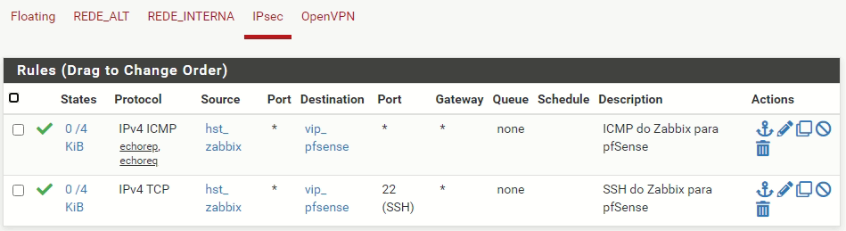

      I created two rules on the Firewall, one for ICMP and one for SSH.
      ICMP works fine - Not sure why.
      Here is the rule and the Packet Capture respectivelly, of the ICMP and the SSH:
      Rules:

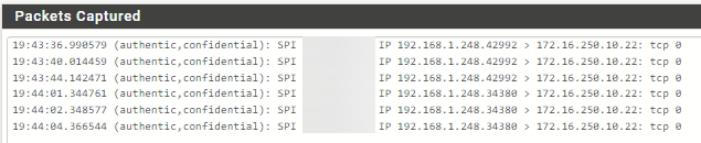

      Packet Capture of the ICMP - Blurred some info because I am not sure what is it for...:
      And here is a Packet Capture of a SSH attempt - Which is unsuccessful, with both a telnet test and SSH test itself on log:
      As you can see, pfSense did not responded like when doing the ICMP.

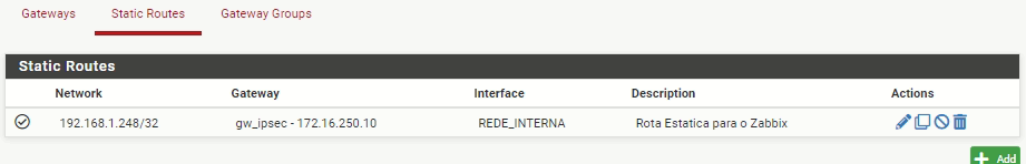

      I want to also inform beforehand that I created a static route for IN → OUT (Which works fine.)

      • stephenw10S Online
        You can't NAT on an IPSec tunnel like that. If you need to NATyou have to use the BI-NAT field in the Phase 2 setup.
        https://docs.netgate.com/pfsense/en/latest/vpn/ipsec/phase-2-nat.html
        Assuming this is a policy based tunnel (not VTI).
