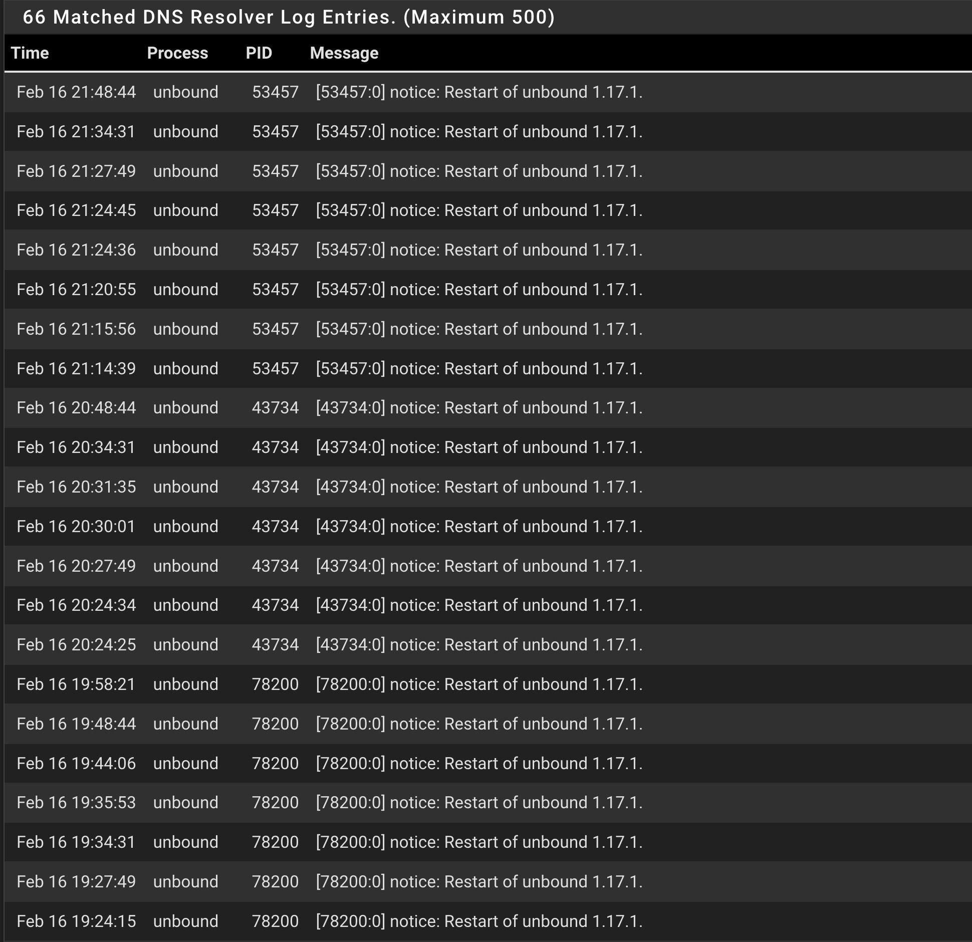

      I watched the new YouTube video by Netgate and in that video the presenter states that with 23.01 it is now OK to enable DHCP registrations in python mode. However, when enable DHCP registrations, this is what I see. 😢

                          @moelassus I think there are maybe a couple of things getting confused in this thread. DHCP registrations trigger an unbound restart, see https://redmine.pfsense.org/issues/5413.
                          The 23.01 release notes say "It is now safe again to enable DHCP registration alongside Unbound Python mode in pfBlockerNG," which is not the above issue.

                            @steveits Yes, I suspect you're right. What I'm seeing however, is that enabling DHCP registrations with Unbound Python mode (with or without pfBlockerNG installed) still results in constant restarts of the Unbound service. My log entry above was with pfBlockerNG installed but I've tried it with pfBlockerNG removed. With registrations disabled, my log shows unbound restarting once per day around midnight. I presume that is normal behavior?
                            With registrations enabled the unbound service restarts multiple times per hour and is down for about 10 seconds each time. Name resolution delays are significant so I'm wondering if I'm an outlier or if others are still experiencing this issue or if I need to do further troubleshooting.

                              @moelassus Unbound doesn't normally restart. I just checked a router on 2.6 (unbound-control -c /var/unbound/unbound.conf status) and it shows "uptime: 15400184 seconds" so ~180 days vs the router's 280 days of uptime. We probably changed a setting. :) [edit: that router has DHCP disabled]
                              I think you're talking about Enable Python Module in the DNS Resolver settings, not DNSBL Mode in the pfBlockerNG settings?
                              The names are similar.
                              Enabling DHCP registrations (currently, see above redmine) writes the change to the config file then restarts unbound to pick up the new config file. So it will restart on average every (#devices/lease time/2) whenever any lease is renewed. Workarounds include having a longer lease time, not enabling that option, or using alternate local DNS servers...such as something that forwards to pfSense but caches so the downtime isn't as obvious.
                              Restarting due to DHCP registrations is a frequent complaint here on the forums.
