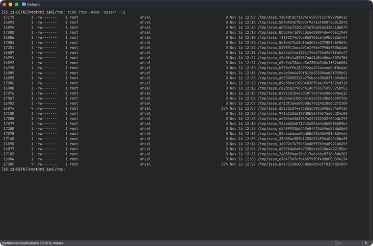

                      @jimp Is this still a known issue somewhere? I have my session timeout set at 1440 (should be 24h) but I get logged out way sooner than that, seems like 1-2 hours. I don't see anything odd in the system log, and my client IP is not changing.
                      I will note: I often see /tmp/sess_* files piling up. I sometimes need to clean these out. There can be dozen or more. All of them have a 0 byte size, with the exception of a single file (which I assume to be the active login session)
                      (25.11 snapshots)
