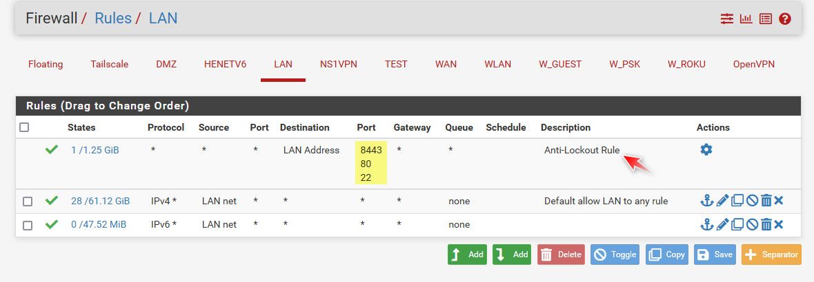

        johnpoz LAYER 8 Global Moderator @furom
        @furom Had you turned off the antilock out rule? Can you not connect via the lan network, this is the network that has the antilock out rule and this rule would be updated when you changed your ports.

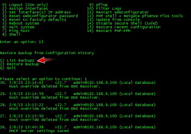

        If you have console access you should be able to just roll back your config, or worse case scenario just turn off all firewall rules to allow you access temp to change the rules to allow your access, etc.

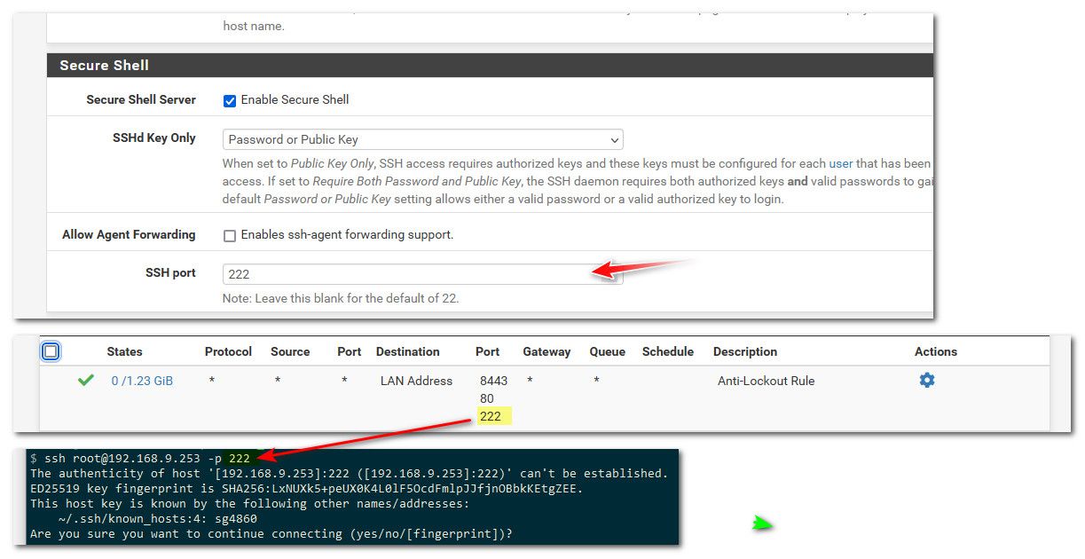

                      @furom so was the antilockout disabled? Were you coming in on a different interface then where the antilock is? When you changed the port this should of changed for sure...
                      Example.. See my previous post, I just changed my ssh port and there you go it changed..
                      And can connect on that port.
                      F 1 Reply Last reply Reply Quote 1
