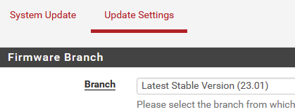

        If you’re on 22.05 set the update branch to the version you’re on, e.g. Previous not Current, to install /update packages.
        If you’re on an 1100/2100 they blocked online updating to 23.01 last night.

          How do I set the update branch to Previous? Tried editing some config file but it didn't work

            @emmaylots said in Upgrade from 22.05 to 23.01 fails device not booting:
            System/Update/Update Settings.
