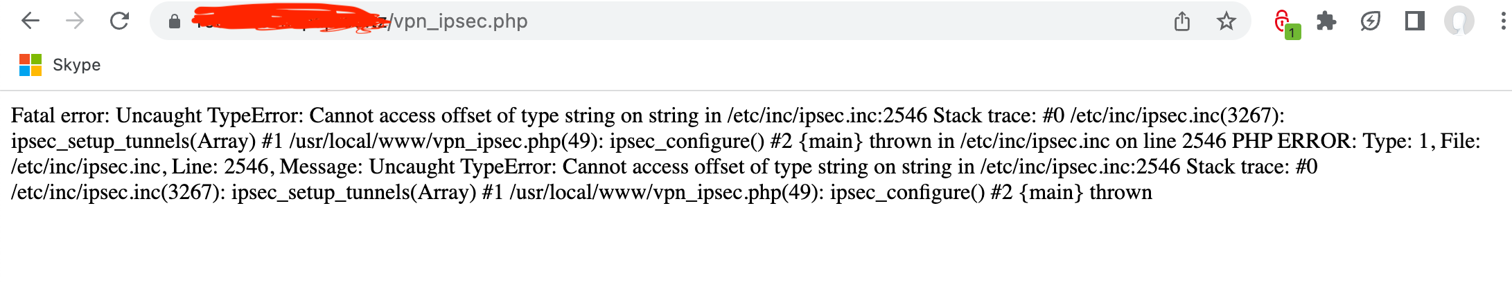

      Using the webconfigurator I tried to enable the disabled tunnel configs, the Apply the Ipsec config changes.
      However, on clicking apply on the WebUI, it would crash and give below output
      On investigating the line on file showing error, below is the code
      Below is the crash dump
      Crash report begins. Anonymous machine information:
      amd64
      14.0-CURRENT
      FreeBSD 14.0-CURRENT #0 plus-RELENG_23_01-n256037-6e914874a5e: Fri Feb 10 20:30:29 UTC 2023 root@freebsd:/var/jenkins/workspace/pfSense-Plus-snapshots-23_01-main/obj/amd64/VDZvZksF/var/jenkins/workspace/pfSense-Plus-snapshots-23_01-main/sources/FreeBS
      Crash report details:
      PHP Errors:
      [26-Feb-2023 09:08:04 Africa/Dar_es_Salaam] PHP Fatal error: Uncaught TypeError: Cannot access offset of type string on string in /etc/inc/ipsec.inc:2546
      Stack trace:
      #0 /etc/inc/ipsec.inc(3267): ipsec_setup_tunnels(Array)
      #1 /usr/local/www/vpn_ipsec.php(49): ipsec_configure()
      #2 {main}
      thrown in /etc/inc/ipsec.inc on line 2546
      [26-Feb-2023 09:09:40 Africa/Dar_es_Salaam] PHP Fatal error: Uncaught TypeError: Cannot access offset of type string on string in /etc/inc/ipsec.inc:2546
      Stack trace:
      #2 {main}
      [26-Feb-2023 09:14:07 Africa/Dar_es_Salaam] PHP Fatal error: Uncaught TypeError: Cannot access offset of type string on string in /etc/inc/ipsec.inc:2546
      Stack trace:
      #1 /etc/rc.bootup(401): ipsec_configure()
      #2 {main}
      No FreeBSD crash data found.
      After failing to restart the Ipsec tunnel from the UI, i tried restarting the server from shell, after which, the Ipsec daemon failed to start completely and all Ipsec tunnels went down.
      Need help with this
