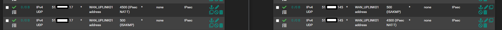

      I am allowing 500 and 4500 UDP on the WAN interfaces on both ends and have 'Allow All' and 'Any' (for testing) on the IPsec interfaces in the Firewall settings.

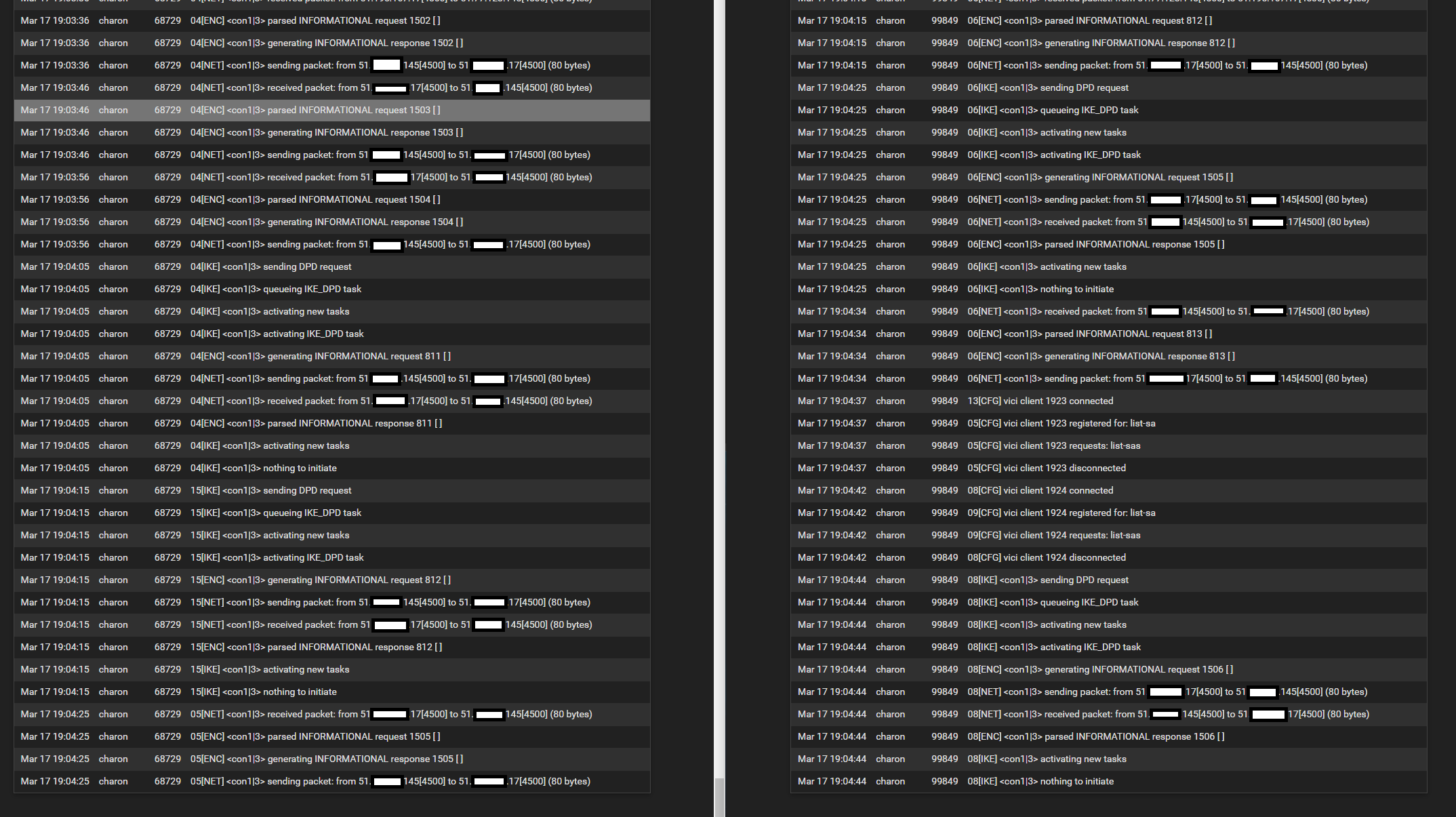

      IPsec Status on the Initiator side:
      I have enabled logging on all of the IPsec related rules, however, I am seeing absolutely no traffic being passed either on the WAN interface, or the IPsec interfaces, both ends.
      This is the output of ipsec statusall.

        Following up with my P1 and P2 from both ends.
        IPsec service system logs (Left - Initiator | Right - Responder):

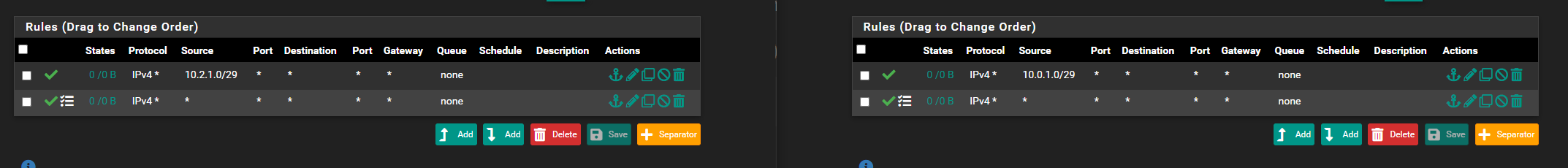

        Firewall > IPsec (Left - Initiator | Right - Responder):
        Firewall > WAN_UPLINK (Left - Initiator | Right - Responder):

          The screenshots show that for some reason traffic does not get into the tunnel ( from both sides ) . The traffic counters are 0.
          To begin with , if I were you , I would check the rules on the Lan interface that
          1 on the initiator's side - traffic is allowed for the network 10.2.1.0/29
          2 on the responder's side - traffic is allowed for the network 10.0.1.0/29
          It should also be remembered that traffic from hosts will get into the tunnel
          10.0.1.1 -10.0.1.6
          10.2.1.1 - 10.2.1.6
          and I also don't understand the Nat settings (in my opinion, in the case of an Ipsec tunnel, such settings are not needed for Nat Outbound)

            I have an Network Alias with all of my subnets, on both sides, attached to the Alias.
            I have Allow All for the alias networks.
