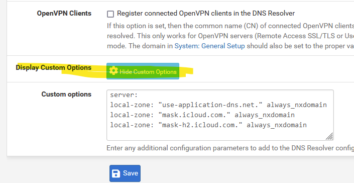

      My questions are;
      1. How can I do the equivelant of local-zone: "zyrtec.1.p2l.info" always_nxdomain in pfsense?
      2. Does pfsense create a zone file for these entries, and if so - where is it? I have written a Python library that automates creating that zone file.
      Thank you.
      • S
        SteveITS Galactic Empire @swills1
        @swills1 if you click the Display Custom Options button you can paste that right in the field. :)
        Don’t know about the details; never looked. It gets written into the config file and anything else will likely get overwritten anyway.

              @steveits Thanks. I meant where is the file in the file system. You've given me enough to go on though. Thanks again.
              • GertjanG
                Gertjan @swills1
                @swills1
                unbound doesn't have zone files like 'bind' has.
                Its (only) a resolver, not really a authoritative DNS server.
                Just one config file : /var/unbound/unbound.conf although this file can pull in other files.
