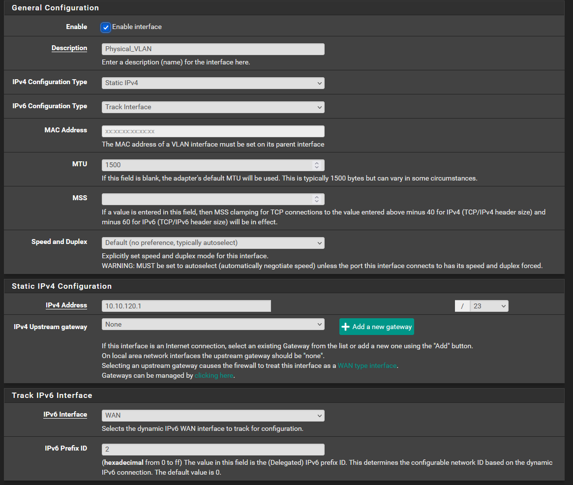

      On every of my Assigned interfaces I have this settings with different IPv6 Prefix IDs:

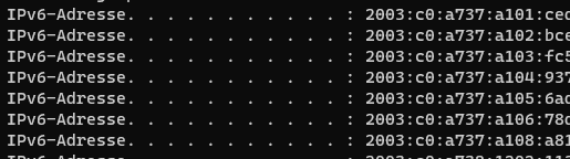

      Whats driving me crazy is now: My Client on that VLAN has not only one IPv6, it has 6! Each from this Prefix:

          sad to see that someone else deals with this issue again. And I saw that this issue only appeares on Windows Clients. On Mac and Linux there is no issue. So year, it's a Windows Bug. My Workaround was to make the port not untagged. I set my Network device to be a tagged device
