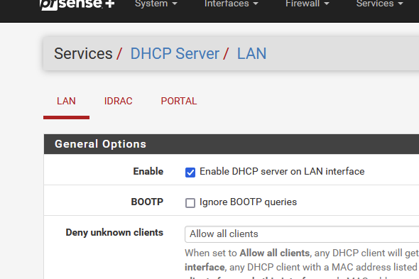

        The DHCP server is bound to a (one) interface :
        This image shows you that I have one DHCP server process that listens to the LAN interface.
        And one for the PORTAL interface, and another for the IDRAZC interface.
        The dhclient can not - will not - should not listen to packets coming into LAN PORTAL and IDRAC.
        The DHCP server on LAN can not see - hear - notice DHCP traffic that comes in the interface WAN, PORTAL IDRAC.
        Etc.
        All this works out of the box.

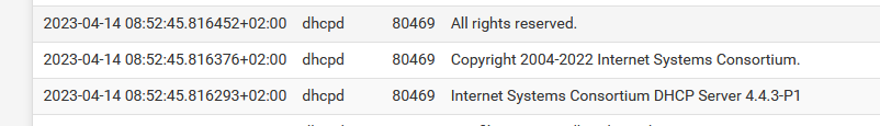

        @iwishitwouldwork said in can pfsense filter isc.org dhcp server traffic?:
        my isc.org dhcp server
        That's the one pfSense uses.

            Gertjan @iwishitwouldwork
            @iwishitwouldwork
            pfSense told me :
            Remember : the logs always contain 'the answer' 😊
