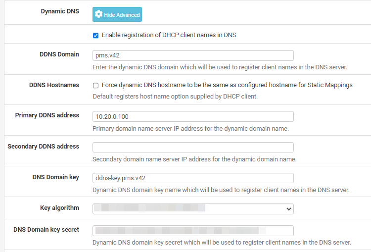

              Get all that going correctly.. then add the pieces to pfsense isc-dhcpd..

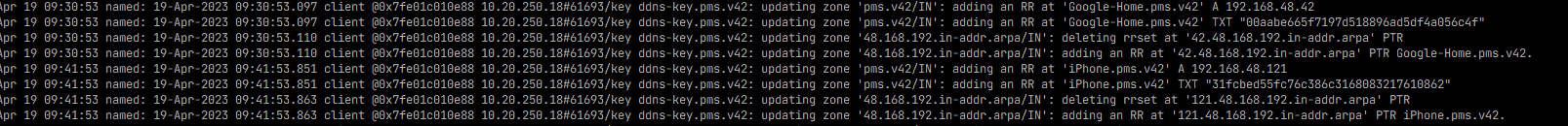

              And when it seemingly works.. it looks like this:
              Still working on the allow-update grant portion.. It seems to update A and TXT records.. I would like to understand that portion better and limit it to "you can only update your own, with your name" A and possibly TXT..
              But for a proof of concept this gives me something to build on and work with..

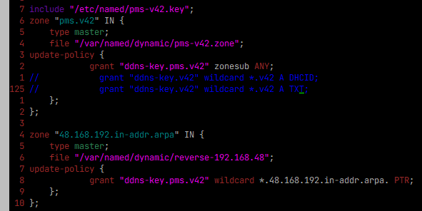

                    Suggestion: "click here to generate named ddns config for this subnet"
                    solution to only allowing A and TXT entries..
                    update-policy {
                        grant "ddns-key.pcsd" wildcard *.pcsd. A TXT DHCID;
                    DHCID is not supported because the ddns-update-style..
                    /var/dhcpd/etc: grep ddns-update-style dhcpd.conf
                                    ddns-update-style interim;

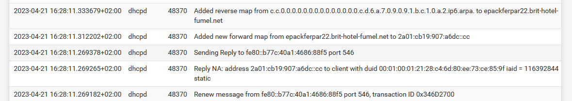

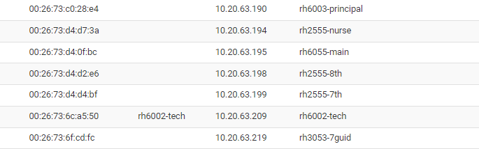

                    So the next problem for which I cannot seem to over come is dhcp reservations.. apparently they do their own thing..
                    2023-04-20T12:17:10.71658 user.notice: Apr 20 08:17:10 named: 20-Apr-2023 08:17:10.715 client @0x7f1b9f682bf8 10.20.250.18#52499/key ddns-key.pcsd: updating zone 'pcsd/IN': update unsuccessful: rh6002-tech.pcsd: 'name not in use' prerequisite not satisfied (YXDOMAIN)
                    2023-04-20T12:17:10.71695 user.notice: Apr 20 08:17:10 named: 20-Apr-2023 08:17:10.716 client @0x7f1b9f682bf8 10.20.250.18#52499/key ddns-key.pcsd: updating zone 'pcsd/IN': deleting rrset at 'rh6002-tech.pcsd' TXT
                    2023-04-20T12:17:10.71697 user.notice: Apr 20 08:17:10 named: 20-Apr-2023 08:17:10.716 client @0x7f1b9f682bf8 10.20.250.18#52499/key ddns-key.pcsd: updating zone 'pcsd/IN': adding an RR at 'rh6002-tech.pcsd' TXT "313202da98edce616f3de3c1db63c48612"
                    2023-04-20T12:17:10.71697 user.notice: Apr 20 08:17:10 named: 20-Apr-2023 08:17:10.716 client @0x7f1b9f682bf8 10.20.250.18#52499/key ddns-key.pcsd: updating zone 'pcsd/IN': deleting rrset at 'rh6002-tech.pcsd' A
                    2023-04-20T12:17:10.71698 user.notice: Apr 20 08:17:10 named: 20-Apr-2023 08:17:10.716 client @0x7f1b9f682bf8 10.20.250.18#52499/key ddns-key.pcsd: updating zone 'pcsd/IN': adding an RR at 'rh6002-tech.pcsd' A 10.20.63.209
                    I have dozens of these:
                    And none of them follow any of the options now that ddns is enabled..
                    they are registered with the parent domain and not with the subdomain at the parent domain no matter what I do..
                    I'm going to say this feels like a bug as nothing I do seems to change anything..
                    I am looking for these reserved devices to be registered in the same subdomain as they are defined in..
                    Again, I probably have 100+ of these across the buildings and networks.. will try defining a few of them in named and see what errors are generated..

                    pfsense dhcpd config for this scope:
                    subnet 10.20.48.0 netmask 255.255.240.0 {
                            pool {
                                    range 10.20.60.1 10.20.62.254;
                            option routers 10.20.48.1;
                            option domain-name "pms.pcsd";
                            ddns-domainname "pcsd";
                            allow client-updates;
                            option domain-name-servers 10.20.48.1;
                            default-lease-time 7202;
                            max-lease-time 28808;
                            ping-check true;
                            option ntp-servers 10.20.48.1;
                            option custom-opt5-0 01:04:00:00:00:02;
                            option custom-opt5-1 "http://option252.pcsd/redacted/redacted.pac";

                    and it's config:
                    zone "48.168.192.in-addr.arpa" IN {
                        type master;
                        file "/var/named/dynamic/reverse-192.168.48";
                    update-policy {
                                grant "ddns-key.pms.v42" wildcard *.48.168.192.in-addr.arpa. PTR;

                        I had to pull this from the loopback in-addr.arpa to get the syntax right..
                        not having the origin as the first line was causing other errors as well.. not sure why..
                        There are hundreds of questions regarding being authoritative for a /21 or /22.. something more than a /24 - no one ever seems to post an answer.
                        afaict the above is valid and working..
                        2023-04-21T13:47:38.50210 user.notice: Apr 21 09:47:38 named: 21-Apr-2023 09:47:38.500 /var/named/dynamic/reverse-10-20:10: using RFC1035 TTL semantics
                        (loopback doesn't say that.. but it's just the 1H, 10M, etc vs time in seconds..)
                        2023-04-21T13:48:48.22222 user.notice: Apr 21 09:48:48 named: 21-Apr-2023 09:48:48.220 starting BIND 9.16.22 (Extended Support Version) <id:59bfaba>
                        Still cannot get pfsense to update the PTR.. still not sure how come..

                          I know, this is 'IPv6' so it's 'dhcp6d' doing doing RF2136 thing.
                          I have "Add reverse dynamic DNS entries. checked.
                          Btw : My IPv6 /56 comes from my ISP, and there is no way I can have this info pushed so 'everybody' can reverse request my IPv6.
                          My web/mail/whatever dedicated server uses bind, and also takes care of zone of my pfsense local domain.
                          So now my server knows how to find diskstation.my-domain.tld by its IPv6, so I can backup my server to NAS behind pfSense.
                          I don't do "registration of DHCP client names in DNS" for my IPv4, as these are ... IPv4 and all RFC1819.
