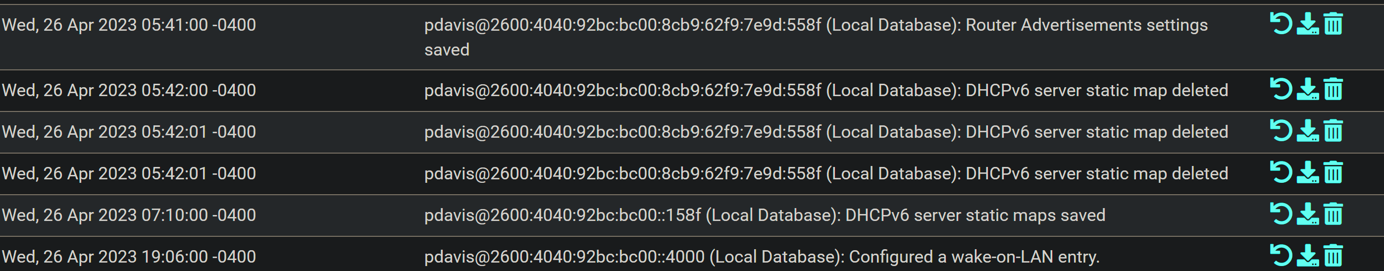

                        The error did reoccur - see below for the logs, the resolver is not showing any issues, but it is showing that Unbound was restarted. The General log shows the error message about the config upload failing.
                        Unbound log:
                        General log:
                        It has been 1/2 hour now since I made that change, and the backup has not attempted to reupload. Also, as another datapoint, the backup didn't fail when I changed some UPS settings in NUT a few days ago.
                        S 1 Reply Last reply Apr 26, 2023, 12:58 PM Reply Quote 0
