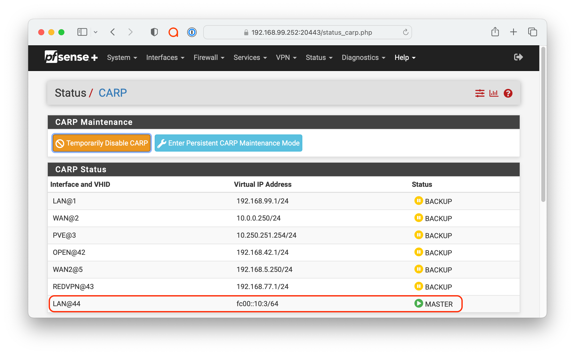

      I have been enjoying HA using pfSync and CARP interfaces for a long time. In my lab where I run one LAN segment (+ WAN) fully dual-stacked mode, however, I've never been able to resolve the dual MASTER situation with an IPv6 CARP interface.
      However, the same physical interface with IPv4 HA and CARP works exactly as expected.
      Running pfSense+ 23.01. Here's my issue in the GUI:
      I am using IPv6 ULAs on my LAN as the ISP here offers only a /128 address on each of my CPE-attached connections.
      The switch between them does not filter broadcast traffic to ff02::12
      The ix1 LAN interface on my first node is:

      The vtnet1 LAN interface on my second node is:
      vtnet1: flags=8963<UP,BROADCAST,RUNNING,PROMISC,SIMPLEX,MULTICAST> metric 0 mtu 1500
              description: LAN
              options=900b8<VLAN_MTU,VLAN_HWTAGGING,JUMBO_MTU,VLAN_HWCSUM,VLAN_HWFILTER,LINKSTATE>
              ether 9a:54:a6:c8:05:fc
              inet6 fe80::9854:a6ff:fec8:5fc%vtnet1 prefixlen 64 scopeid 0x2
              inet6 fc00::10:2 prefixlen 64
              inet6 fc00::10:3 prefixlen 64 vhid 44
              inet 192.168.99.252 netmask 0xffffff00 broadcast 192.168.99.255
              inet 192.168.99.1 netmask 0xffffff00 broadcast 192.168.99.255 vhid 1
              carp: BACKUP vhid 1 advbase 1 advskew 100
              carp: MASTER vhid 44 advbase 1 advskew 100
              media: Ethernet autoselect (10Gbase-T <full-duplex>)
              status: active

            davidredekop
            Sometimes just articulating the problem in writing helps me solve my own issues more methodically.
            On further investigation, looks like Proxmox applies Multicast snooping by default, that's why node2 could never receive the advertisement even as a linux bridge.
            So the following setting turns off the Multicast snooping:
            echo 0 > /sys/devices/virtual/net/vmbr0/bridge/multicast_snooping
            After the reboot, I now have proper MASTER/BACKUP on the IPv6 also.
            Good to know now how IPv4 differs so much from IPv6 :)
