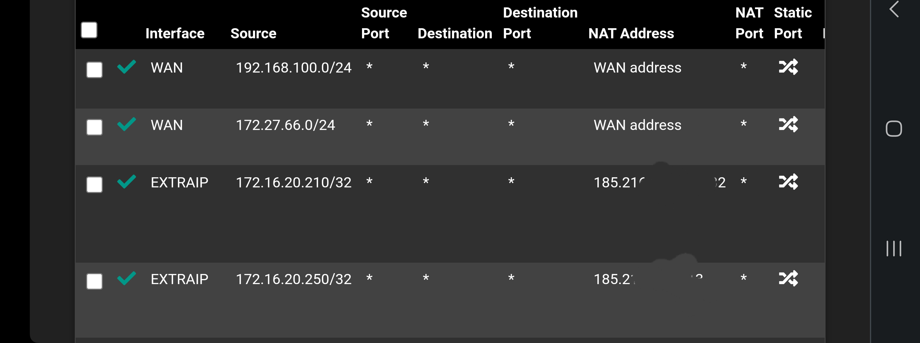

          @operations huh, ok. Can you post your outbound NAT rule page?

            @steveits said in Outbound NAT rules not working:
            I think 2 gateways is a problem in pfsense since 2.5.2 with regards to outbound nat, not 100%.
