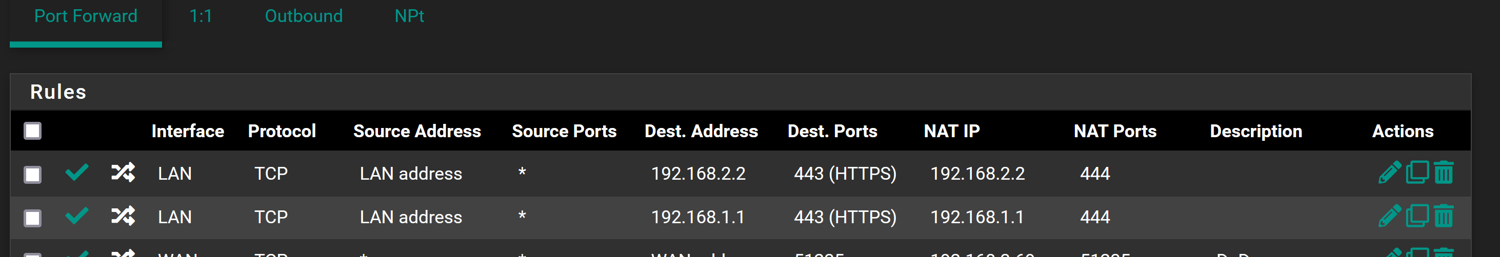

    I am trying to start setting up my local resolutions but need some specific port to be adjusted as i have certain services running off port by 1 (so, my TrueNAS runs its interface as port 444 rather than 443, same with my pfSense box).
    Anyway, im trying to set up the forwarding rule, but i dont seem to be doing something right.
    Attached is a pic of my NAT rule(s). I want all local traffic going to 192.168.1.1:443 to go to 192.168.2.2:444 (same with 192.168.2.2:443 to 192.168.2.2:444). Further accomplished by local DNS fulfilment (which currently works. if i go to pfsense.home:444 it takes me to my pfsense box.)

      @menethoran
      Source LAN address might not really be what you have.
      M 1 Reply Last reply May 9, 2023, 5:40 PM Reply Quote 0

        @viragomann well, i dont want ANY, because that would cause issues with calling servies from my truenas (192.168.2.2 which hosts services behind traefik on port 80 and 43, forcing everything into https)

          @menethoran
          I don't know, what you need. But your rules actually only forward packets coming from pfSense LAN address on LAN interface.
          I'm in doubt that this one gets any hits.

            But 'LAN address' is the IP of the pfSense LAN interface. No traffic is ever going to come from there into the LAN. It can never match anything.
            You probably want 'LAN network' there.
            That shouldn't ever match the Truenas address because I assume that cannot be in the LAN subnet. That portforward can never work if it is.

              @stephenw10 switched source to 192.168.0.0/17 (i THINK thats the correct subnet to include all 192.168.X.X)

                It would be /16 but that's probably not necessary. The port forward is on the LAN interface so the only traffic that can hit it will be from the LAN subnet or other subnets routed via some gateway on it (which you probably don't have).

                  @stephenw10 i have 2 networks (IoT and Home). IoT exist on 192.168.2.X-192.168.3.X, Home exists on 192.168.1.X. I want all local traffic trying to reach 192.168.1.1:443 (or more specifically, https://pfsense.home resolves to 192.168.1.1:444, it currently resolves to 192.168.1.1:443. 192.168.1.1 = PfSense, port 444 = port 443, but changed because of security?... (same with another service. though, ultimately, i dont really care if PFSense resolves straight to 443 and i just set the access port back to 443, BUT, i need to know that the 443 to 444 redirect works correctly, as another item on the network needs that to happen (ie, its access is on 444 becasue it cant exist on 443 because another servie monitors that port)

                    @menethoran and why would say 192.168.X.X/17 or /16 send traffic to pfsense if its trying to go to 192.168.1.1 or 192.168.2.2 ?
                    Not sure what you hoping to accomplish here?
                    If your devices on 192.168.2.2 and 1.1 listen on 444, then talk to them on 444
                    Why are you having them listen on 444 if you want devices to use 443 to talk to them?
                    What exactly are you wanting to happen, and we can either go over why that something doesn't make any sense, or how to do it. From what you have posted so far it doesn't make any sense.
                    But the only way a port forward for sending traffic to 444 vs 443, would be if pfsense receive the traffic to route to 2.2 or 1.1 from whatever client is trying to talk to those IPs. But if your devices are on some /16 or /17 network that includes 2.2 or 1.1 they would never send the traffic to pfsene in the first place.

                        A port forward on LAN should then be:
                        Source: LAN net
                        Destination: LAN address
                        Target: LAN address (though you could also use localhost here for clarity).

                            Is that traffic pfsense would route? pfsense is not involved in conversations between devices on the same network.
                            If you have this say
                            client lan -- pfsense -- optx -- nas
                            Where client and nas are on 2 different networks you could do with with simple port forward.
                            If nas and client on same network, you could do it with say a haproxy setup, where you hit a port on pfsense, and the proxy sends it to the nas.. I do this for couple of services, since I am having haproxy do the ssl offloading, and the destination services run on odd ports and don't even support ssl, etc.
