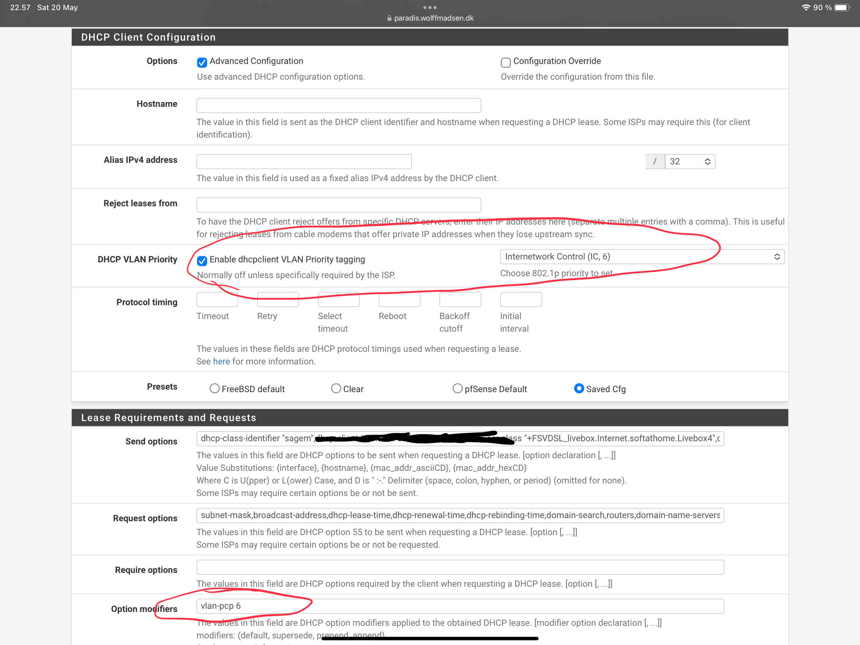

                              Not quite - I can understand the confusion. Here’s a screenshot:
                              I did not have the first red buble enabled (priority VLAN tagging) because several posts and a redmine says it’s overridden anyways when you enable “Advanced configuration”.
                              In Adv. Config I have enabled “vlan-pcp 6” (Second red buble) which supposedly does the same thing as the first.
                              But that not actually quite true. The first buble - apart from adding “vlan-pcp x” to dhclient.conf - also adds the VLAN priority set to the automatic builtin “pass-out DHCP rule from WAN”.
                              Adding “vlan-pcp 6” to modifiers only adds “vlan-pcp x” to dhclient.conf but does not enable the “set vlan prio” in the auto rule - thus RENEWS are not priority tagged - only DISCOVER.
                              But it seem by enabling both I get the best of both worlds - just need to make sure to set them to the same priority. Now i just need to confirm it actually works (I have a packet capture lined up for my upcoming renew in 10 min :-))
                              Update: I can confirm it works now. I just renew’ed my IP by doing my setup as described in my post.
                              I’ll update my redmine stating this “workaround”.
                              I’m a little confused if this is in fact intended behavior, but if it is, there is a lot of info online to the contrary - including redmine posts by Netgate

                                  Hmm, interesting. Glad you found a workaround until we can rework this to something more usable.
                                  I agree that comment implies that either advanced config or config override will remove that setting but it doesn't seem to be the case. And I'm not sure why it would. Config override certainly would but enabling advanced config should not. And doesn't.
                                  However I also don't expect you to need to set 'vlan-pcp 6' as a manual option with that set. It should do the same thing.
                                  • keyserK Offline
                                    keyser Rebel Alliance @stephenw10
                                    @stephenw10 said in How to hack built-in DHCP Client pfrule?:
                                    Not sure I agree - it does seem to be the case, because it’s not enough to only enable the first red buble settings. Then DISCOVER and RELEASE are not priority tagged correctly and there is no “vlan-pcp x” setting in dhclient.conf if I have advanved settings enabled. That seems to suggest it was overwritten by enabling advanced config. With dhclient using a bgf? Interface for discover and release, I assume the builtin pf-rule “set prio x” has no effect on packets through that and thus needs the dhclint.conf setting as well?
                                    Agreed, this probably should be made simpler in the interface.
                                      Right so it overrides the actual 'vlan-pcp 6' entry, so the bpf rule, but not the fact it's enabled which is what sets the tag in pf.
                                      • keyserK Offline
                                        @stephenw10 Yep, that’s what my testing shows.
