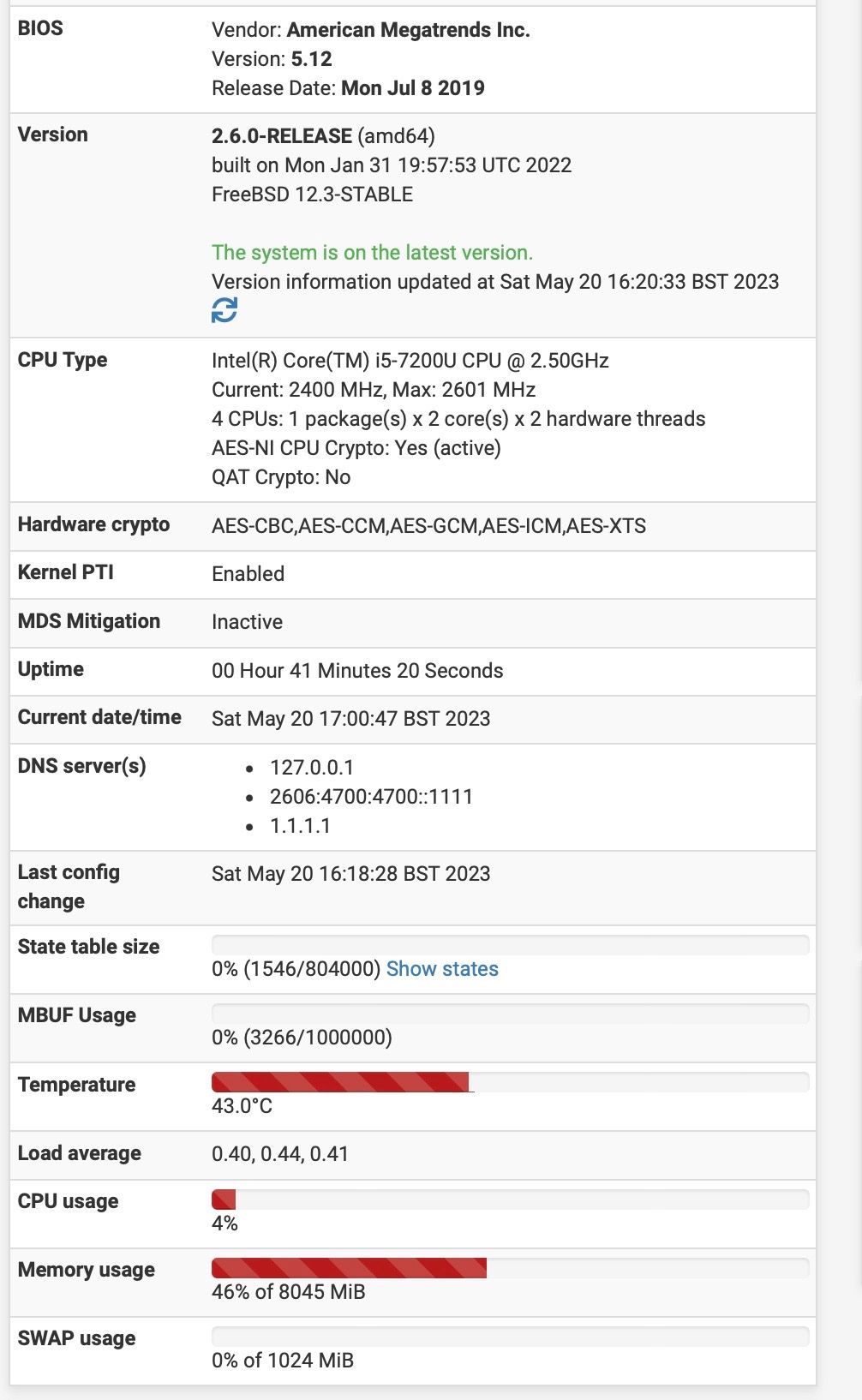

      Apologies, this is a slightly longer post and I want to give sufficient information of all the things I have tried already to resolve
      Issue/Symptom:
      DNS resolution fails for some domain after a period of time has passed. Things work fine after a restart only to have the same issue with some domains(not all) failing to resolve.
      Analysis and setup:
      I have done packet captures (can post it here if needed) when it is working fine and when it doesn't. The DNS query request seem to go out fine at all time to external DNS servers but there is no response (no packets received) for some queries once the issue starts to manifest.
      I use pfsense DNS forwarder going to Cloudflare DNS on ipv4 and ipv6
      The network is dual stack
      The system memory usage seems to creep up. Memory usage start around 24% of 8gb available and slowly creeps up and the issue starts to appear when the usage is about 53 or 54%
      What is making this weird is that the DNS packets seem to go out, but there is response from the server initial after a restart and no response for some domains as time progresses. I have tried lot of other public DNS as well cloudflare, google, 9.9.9.9 and all have the same behaviour leading me to think there is something wrong with the pfsense box.
      Any pointers to further investigate and resolve this issue will be appreciated. Thanks.
      Edit: System information screenshot attachedImage 20-05-2023 at 17.01.jpeg
