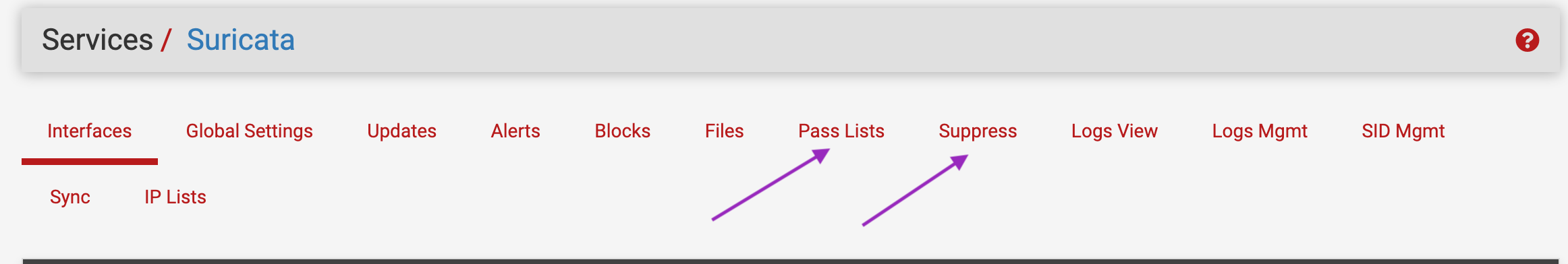

        @manilx said in Can I (how do I) exempt traffic from certainIP's from being scanned:
        So can I exempt certain IP's from "entering" the suricata scan?
        Sure you can...either create a pass list or suppress a rule (qnap) for a certain IP.

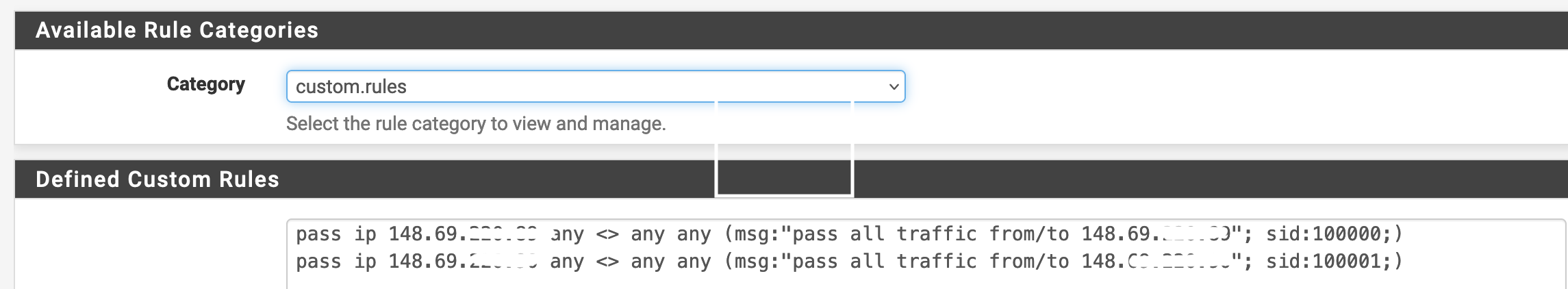

                          @bmeeks Found it!!!!
                          Added 2 rules for both IP's I want excluded:
                          pass ip 1.2.3.4 any <> any any (msg:"pass all traffic from/to 1.2.3.4"; sid:100000;)
                          Netgate 8200max

                              • bmeeksB
                                bmeeks @manilx
                                Make sure you incremented the SID for each rule so that you do not have a duplicate SID!
                                • M
                                  manilx @bmeeks
                                  Netgate 8200max
