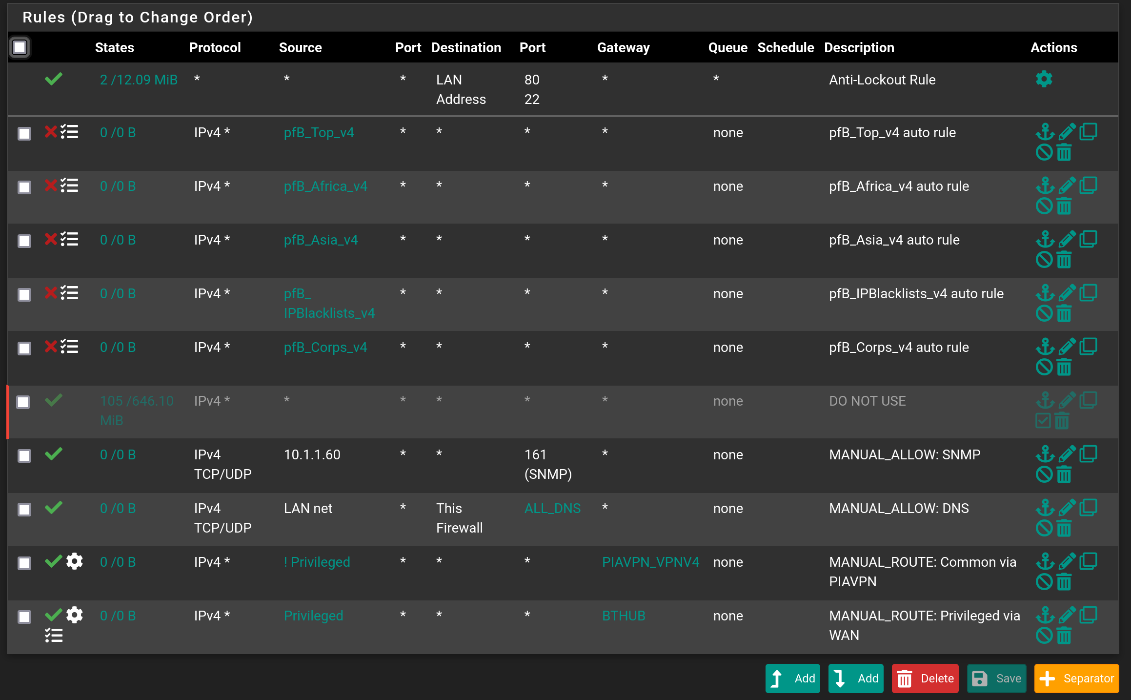

      I know this keeps getting asked but I'm really stuck.
      I keep going back here to double check my work but it seems fine!
      Basically, if a host matches a group I call privileged, the gateway is direct to WAN. If it does not, the gateway goes through the VPN.
      But my public IP is shown when I used:
      curl ipecho.net/plain
      I can push traffic through the correct interface by doing this on the firewall shell:
      curl --interface ovpnc4 ipecho.net/plain
      There's no errors in the openvpn client log, and I turned the gateway monitoring off for it.
      I have tried turning off pfblockerng, but that doesn't help either.
      Can someone please help me?

      • V
        viragomann @ctuchik
        @ctuchik
        Enable the logging in both concerned rule and check then, which is applied to the traffic.
        Consider also to flush the states.

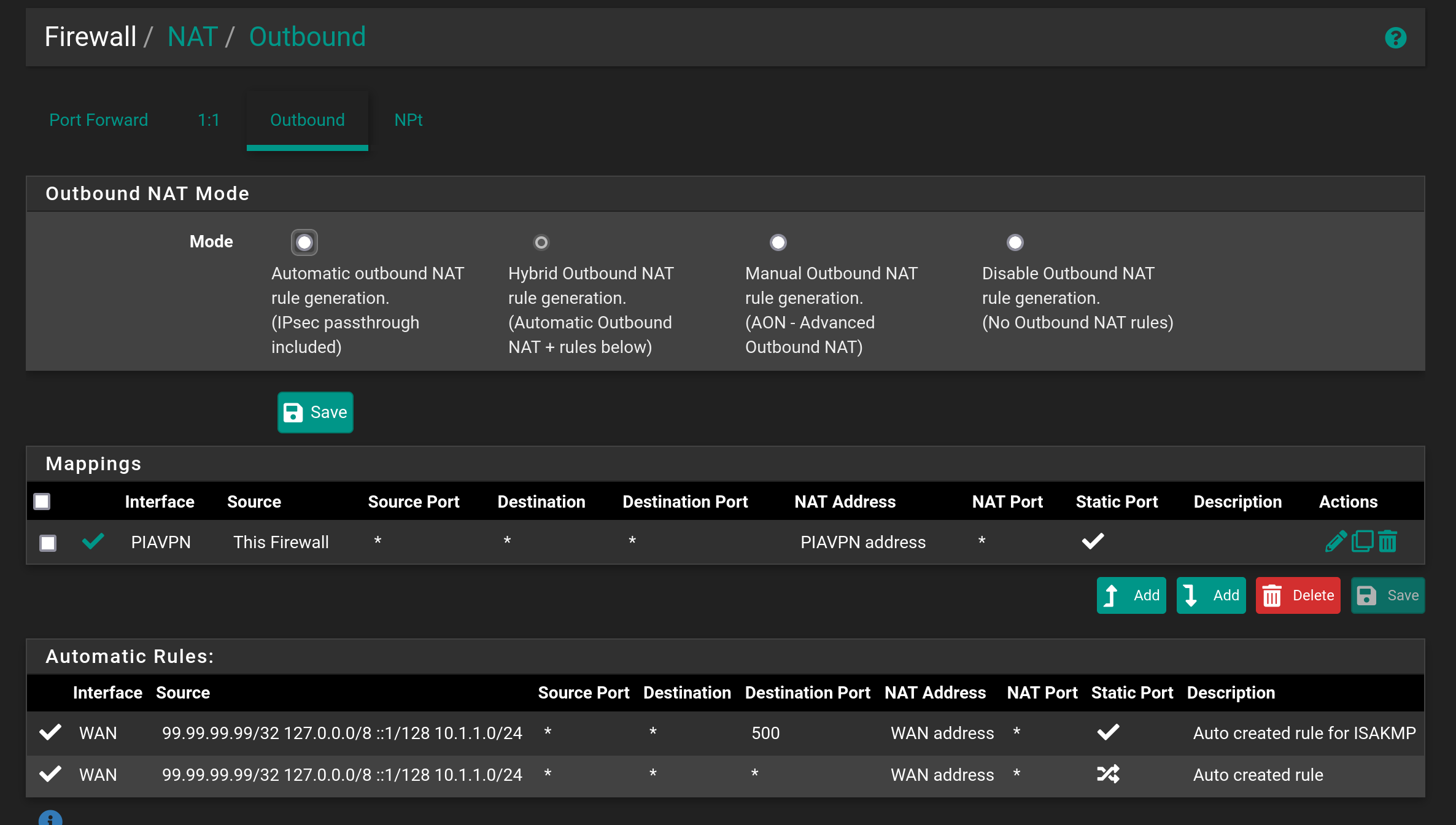

                @bob-dig In case I get reprimanded for what seems like outbound NAT not being in manual mode: This firewall is virtual, and I did try a VM snapshot, moving to manual, copying the correct rule and changing the interface to openvpn instead - this fixed nothing.
                Here is how that looks at the moment:
                Perfectly happy to do it again though?

                • Bob.DigB
                  Bob.Dig LAYER 8 @ctuchik
                  @ctuchik With that screenshot shown, it is no wonder, that it is not working. For OpenVPN you need to make some rules like it is described in the tutorials.
                  You could try to replace "this firewall" with any, for testing.

                    • C
                      ctuchik @Bob.Dig
                      @bob-dig It's working, you were right and I'm grateful you helped :)
                      If you wouldn't mind helping me learn how this fixed my issue?
                      I vaguely understand the rule to mean this: "any outbound traffic on this interface should be translated as if it has come from the current VPN address", so since I mentioned "this firewall ", doesn't that cover everything already?
                      • Bob.DigB
                        @ctuchik It covers only the firewall itself. "Any" is not advised though, you should define all the source networks (LANs) you like to use with the vpn.
