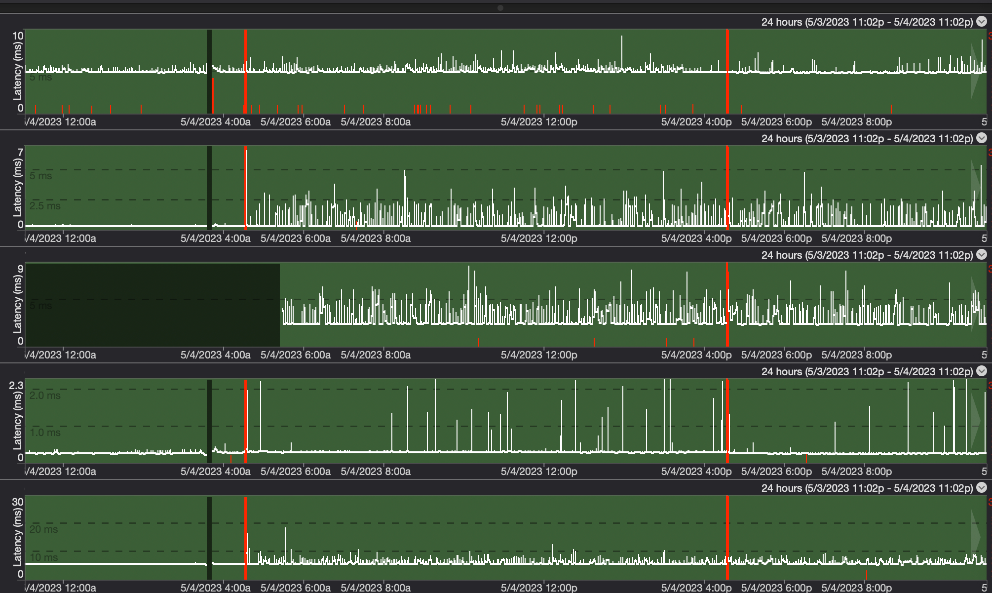

          First one shows the v23 upgrade on 5/4 at around 4am and how it's clean before, and has the traffic after. Of the 5 things being monitored:
          #1: a public IP around 5ms away
          #2: the pfsense fiber transit WAN IP on our end
          #3: the pfsense fiber gateway, 2ms away
          #4: the pfsense internal OPT IP on our allocated block that our pingplotter monitoring interface is also on
          #5: 1.1.1.1

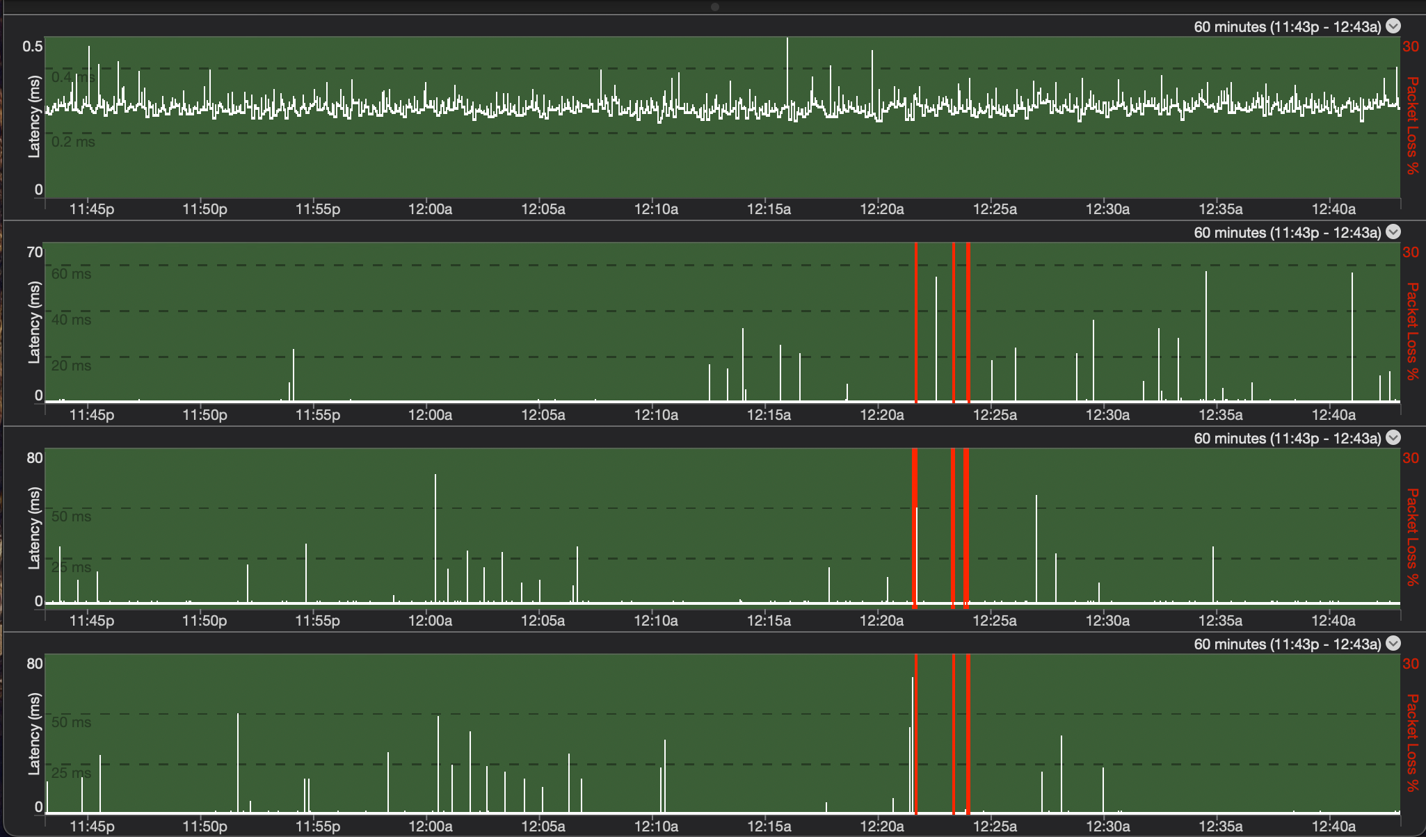

          Second one shows the recent 60 minutes. the 3 packet drops are me toggling autonegotiation to manual on a few of the ports. Four things monitored:
          #1: a device on our internal WAN block which is unaffected as we can ping it without going through the pfsense, and pinging it from all the other machines on the network are clean as well

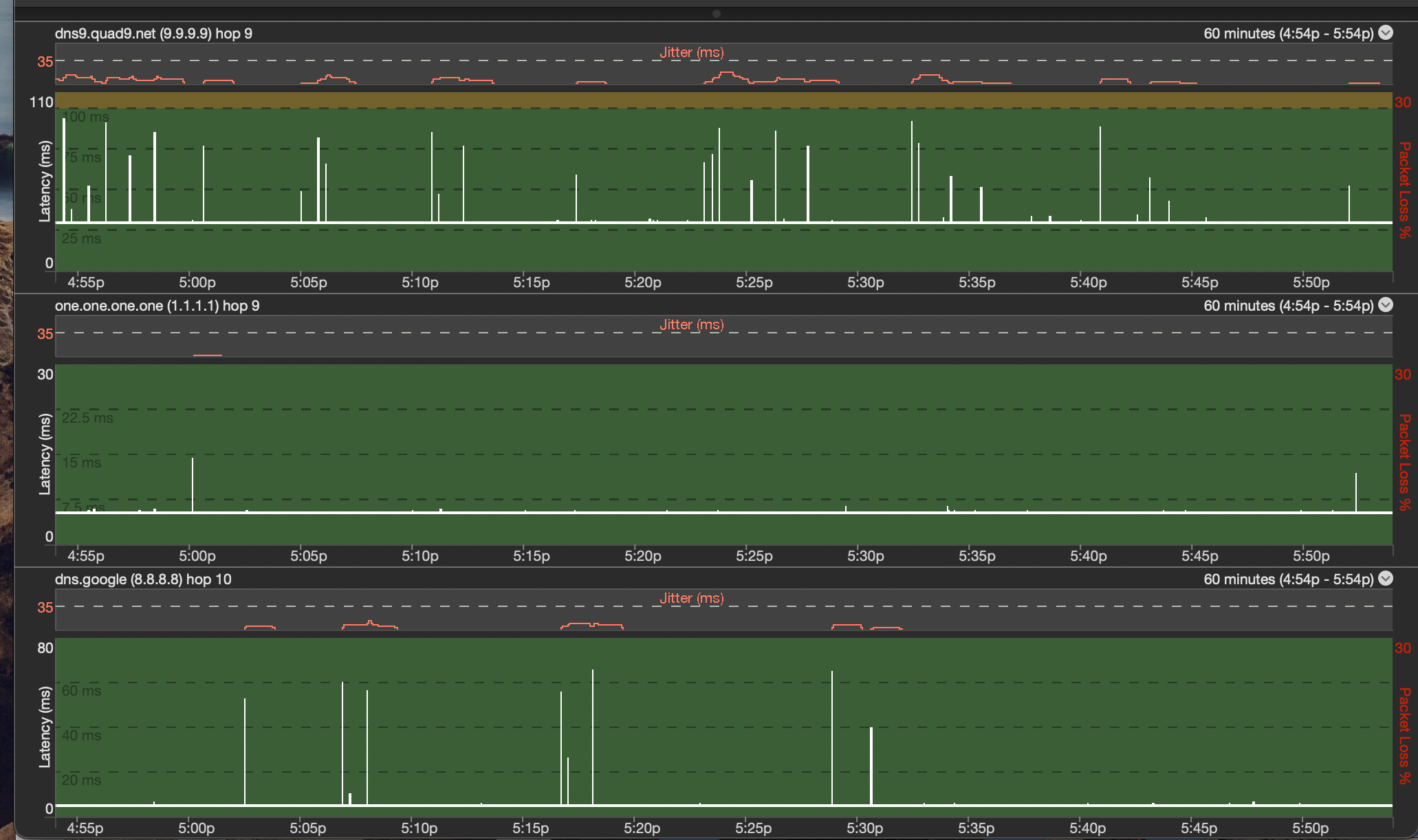

          Third one shows a ping to 1.1.1.1, 8.8.8.8, 9.9.9.9
          A curious thing about all this is, some destinations seem more affected than others and its very random and chaotic.
