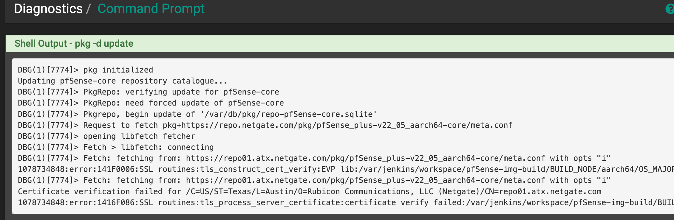

      I see this message on my SG-1100. Is the SG-110 EOL now?
      Also this:
      • bmeeksB Offline

        The crypto chip inside the SG-1100 has a history of getting stuck in an invalid state. The only way to reset it is to physically power down the box, wait several seconds, then apply power again. A reboot is not sufficient to reset the crypto chip.
        Shut down your SG-1100 from the menu. Be sure is has fully halted, then remove the power. Wait several seconds then power it up again and let it boot. If the crypto chip is the issue, things should work better for updating.
        To be positive the box has halted, it would be beneficial to connect up the USB serial console cable and watch the firewall's console via the PuTTY serial connection to be sure it has halted. If you remove the power before the box fully halts, it is possible to corrupt the file system.
