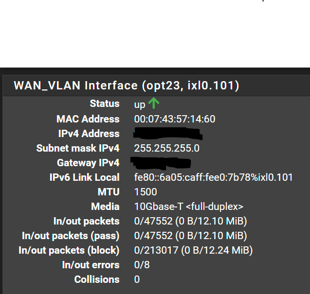

                                        sef1414 @johnpoz
                                        @johnpoz Pretty sure. It was copied from the MAC address field of the interfaces status page on the primary box. Just verified that it is correct. Perhaps I'm missing something.
                                        Guess I will need to do a more verbose packet capture?
                                        All I saw was these lines on repeat:
                                        13:21:56.318459 IP 0.0.0.0.68 > 255.255.255.255.67: UDP, length 300

                                            sef1414 @johnpoz
                                            @johnpoz
                                            Alright so I was able to do some more testing, and it is pretty bizarre compared to what I believe should be expected behavior.
                                            I've checked a countless times at this point to ensure the MAC from my primary box is set on the WAN interface of the secondary box. I would expect that my modem can not tell the difference between the two boxes, and both pfsense boxes should be able to grab the same IP from my modem if I disable the WAN interface on one of them, or even perhaps both simultaneously, though I would expect issues in that scenario.
                                            Here are the steps I took with the results:
                                            • On pfsense primary, put down WAN interface via ifconfig in SSH session
                                            • Physically plug ethernet cable from pfsense secondary into trunk port 5 on switch
                                            • Pfsense secondary shows WAN connection as up, but doesn't receive an IP address
                                            • Unplug pfsense secondary from trunk port 5, and plug it into trunk port 1 (where pfsense primary was previously plugged in)
                                            • Pfsense secondary obtains an IP quickly (without modem reboot) and has connectivity - With a different IP address!
                                            • Unplug pfsense secondary from trunk port 1, replace pfsense primary into trunk port 1. - Pfsense primary grabs the previous IP.
                                            I could see it possibly being a switch configuration issue, though I've been over that a dozen times as well. That would not explain pfsense secondary getting a different IP though. My best guess is MAC spoofing is not working somewhere between the interface and modem.
