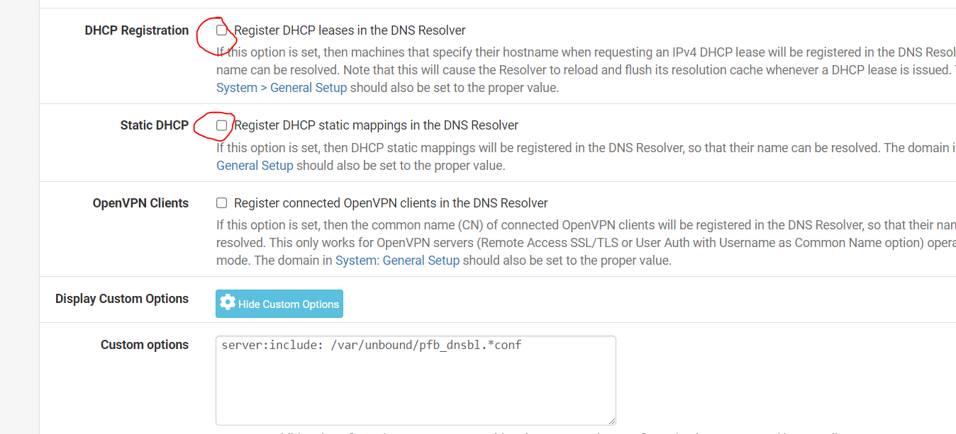

      Hello I don't understand why but if I enable those two items, navigation, or rather the resolution of the dns becomes very slow, sometimes I have to refrash the page to open it correctly.
      in fact, if I disable them, navigation returns fast.
      what can i do to fix it?
      • bmeeksB Offline
        bmeeks
        You appear to be running the pfBlockerNG package (likely with DNSBL enabled).
        When you check the DHCP Registration box, each time a DHCP client of the firewall renews its lease the unbound DNS Resolver will be restarted so it will read the DHCP leases file again (to obtain IP to hostname info).
        With DNSBL and large block lists enabled, it can take quite some time for unbound to restart. During the restart interval your system has no DNS functionality. LAN clients will see that as a sort of loss of connectivity because no domain name to IP resolution can happen.
        Some LAN devices (particularly smart home gadgets) will renew their DHCP lease quite often resulting in frequent DNS restarts. pfBlockerNG will also restart unbound each time it updates a downloaded list. Taken together these instances can result in a lot of unbound downtime.
        Until the pfSense developers rework the way dynamic DHCP hostnames are handled, it is best to leave the DHCP Registration box unchecked.

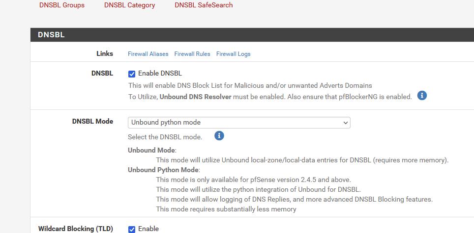

            Because you're using pfBlockeng, activate the 'python' mode.
            Right now, you saw that the resolver is often unavailable - and for a rather long duration.
            You understand it now : You did everything to create this situation, and to make the worse of it ;)
            This option :
            is by default not activated. '...... for reasons ....' (see the other 1000+ forum posts about the subject.
            You can activate it - and nothing will happen if you use one or two LAN devices, and all using Static IP settings ๐Ÿ˜Š This means there won't be any DHCP "leases" activity.
            Or use Static MAC DHCP leases for all your devices.
            This issue is being redesigned and rewritten right now, and soon, "DHCP Registration" won't have the 'resolver restart issue" any more.

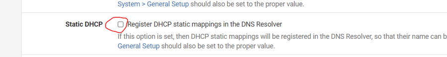

            This option :
            can be activate without any consequences.
            Static leases are read when the system start - or when, you (the admin) add/remove/modify one.
            That's normally a very rare event.

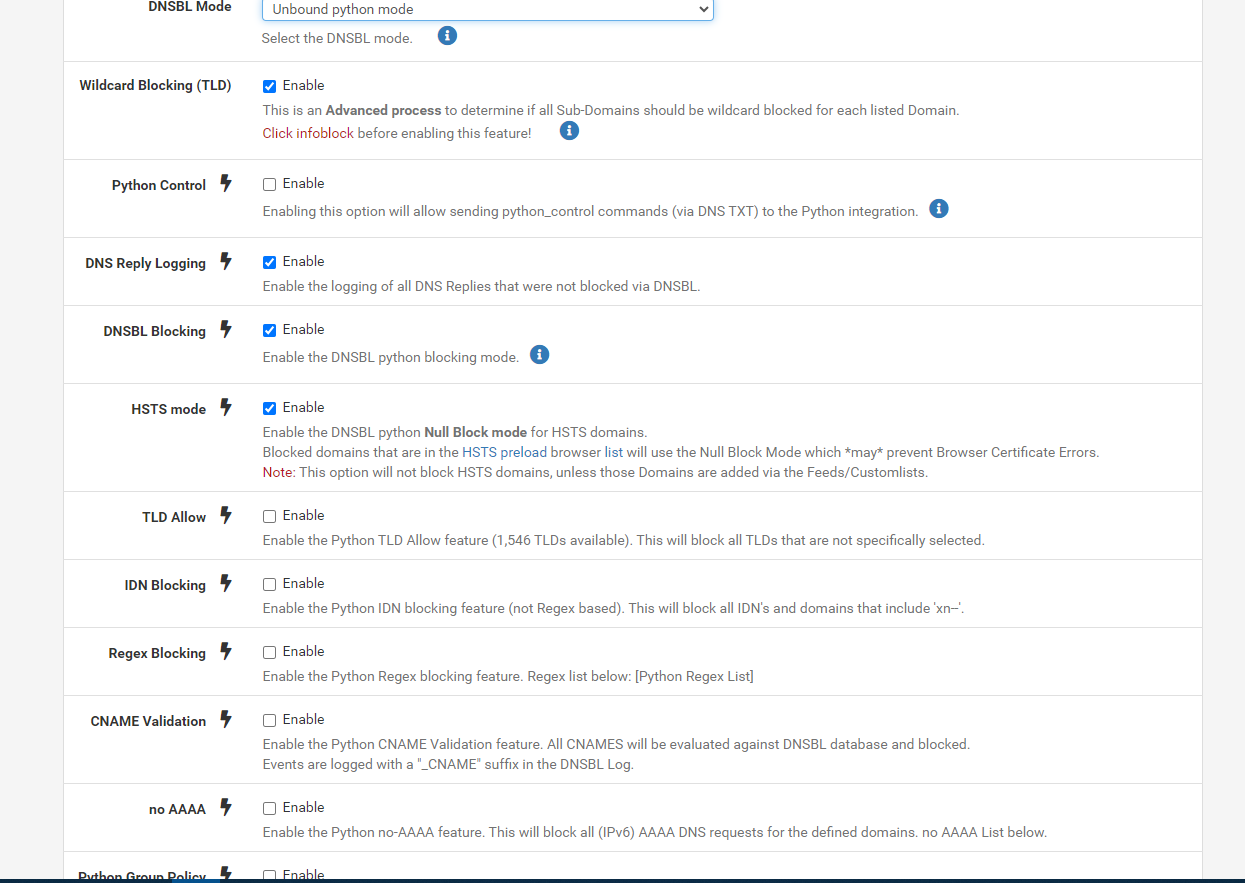

                Python Control : Click on the 738b0ead-f2b1-4e36-b87f-74f1e1fdbd3e-image.png and read.
                If you say : "hey, I need that", then activate it.
                No nasty side consequences afaik.
                TLD Allow / IDN Blocking : like salt and pepper : add according to your taste.
                Regex blocking : be careful : very powerful and aggressive blocking. If the word 'regex' doesn't mean anything to you, stay away.
                NoAAAA : if you want to force IPv4 to certain hosts.
                Group Policy : These IPv4/IPv6 will not be filtered. Like : your PC isn't DNSBL filtered, everybody else (not listed) : they will be filtered.

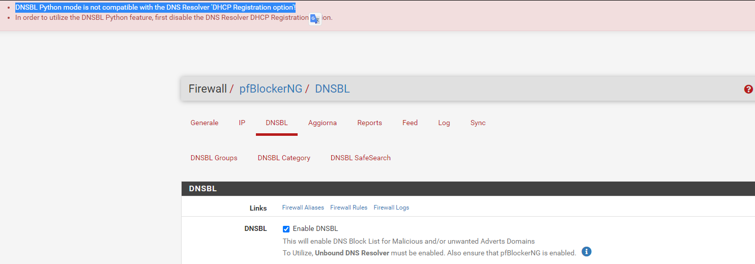

                      As you've discovered, "DHCP Registration" restarts unbound (the resolver) 'all the time'.
                      This was creating severe issues- memory loss, restart problems etc.
                      This was somewhat resolved with latest pfBlockerng and latest pfSense (23.05).
                      Make life easy on yourself : "DHCP Registration" => do not activate it.

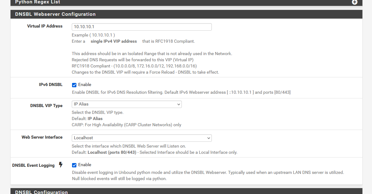

                      @wifi75 said in Dns resolver problem:
                      one question, but is it possible to associate a web page that informs that the site has been blocked by pfsense? just to figure out who blocked what?
                      That's what
                      is all about.
                      But ...... here it comes : this only works for http:// access.
                      Not https://.....
                      Better yet : you don't want it to work for https://....
                      So, again :
