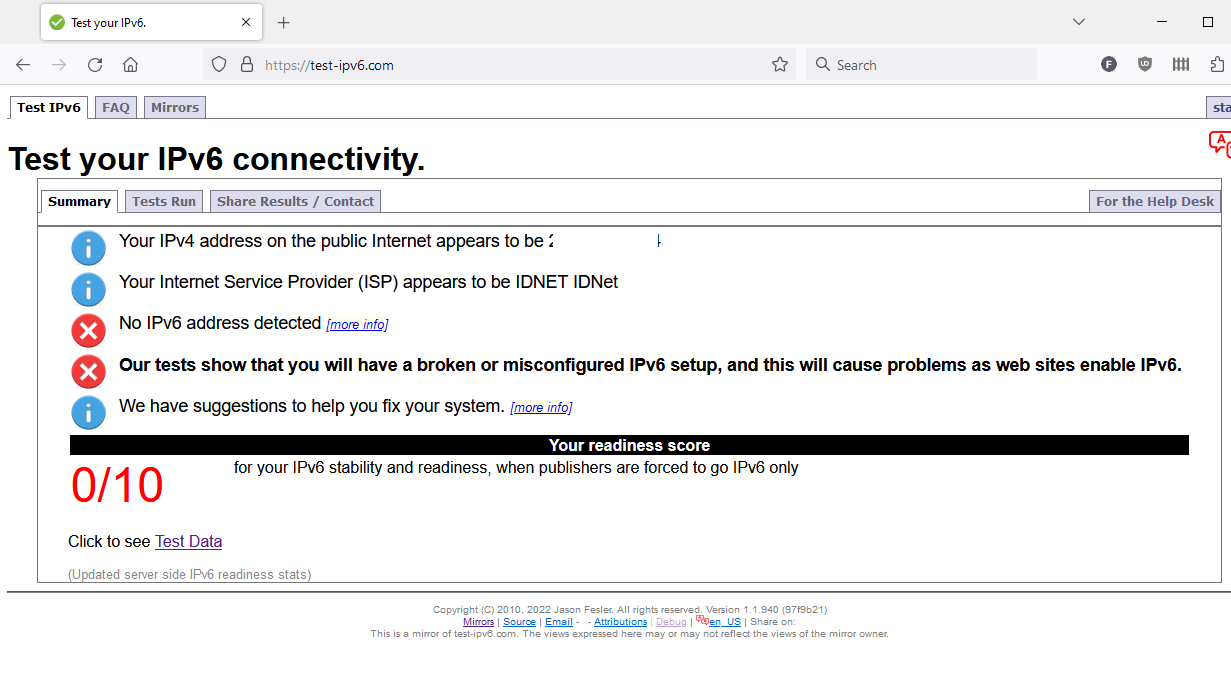

        If I go to test-ipv6.com
        What issues?

          What issues?
          I knew I'd miss something.
          IPv4 tests are OK. Any other test will time out after 15 seconds.
          Opening one of the idividual tests in it's own tab will time out.

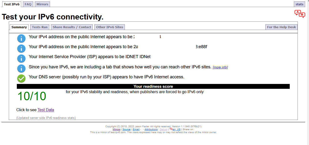

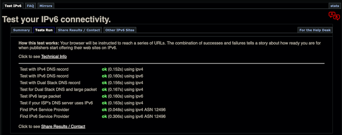

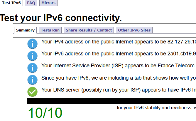

                Ok, you didn't saw this one :
                What you want to see and share is this one :

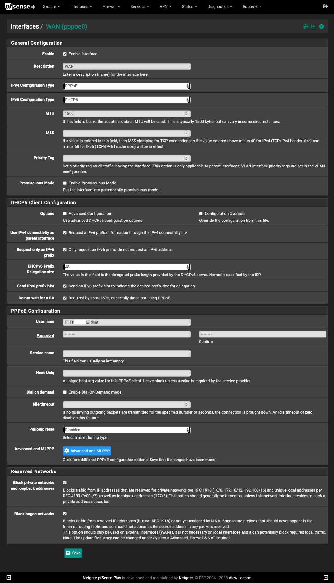

                  Help offered - I'm also with iDNet (good idea going with a quality ISP over a cheap one) so can offer any settings you need. ๐Ÿ‘

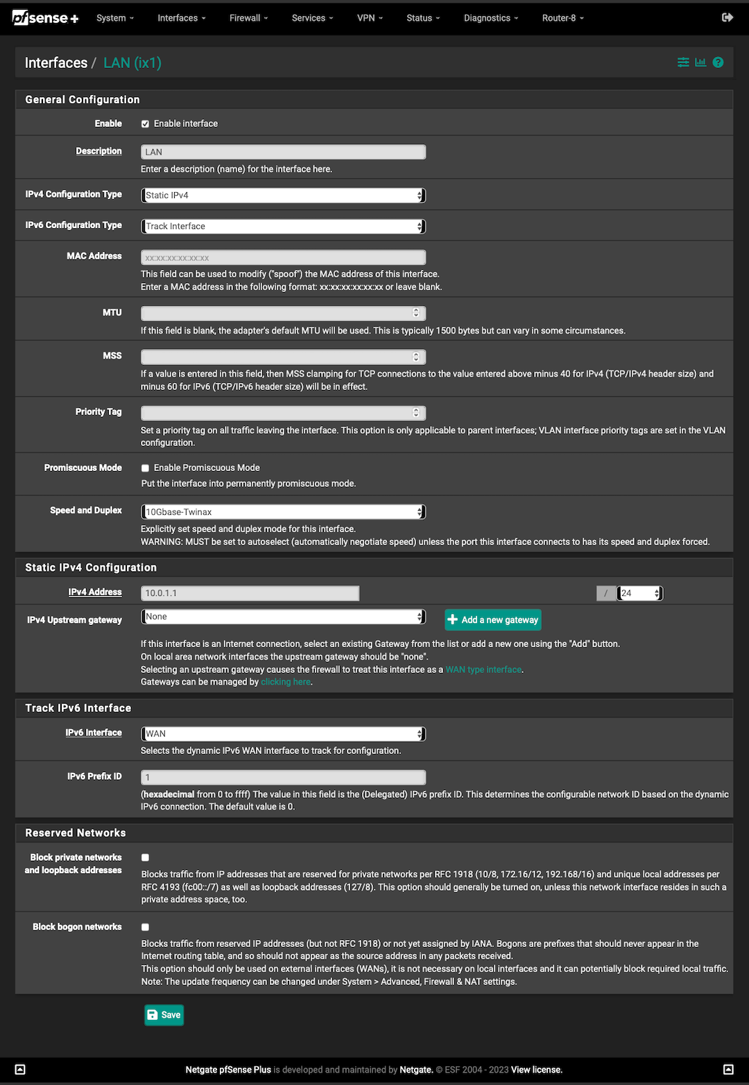

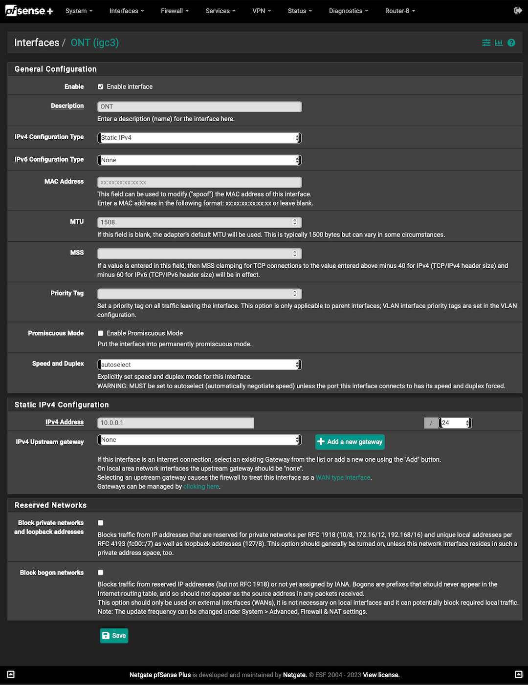

                    The physical WAN link (to my ONT) - Don't miss the 1508 MTU setting for PPPoE overhead:
                    Main LAN configuration:
                    Hope these help - if not just ask.

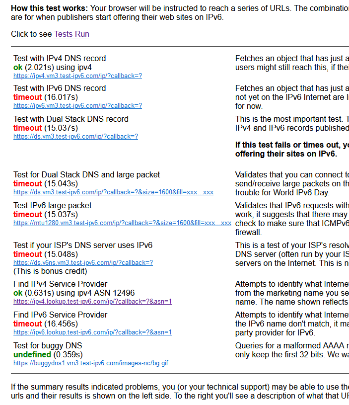

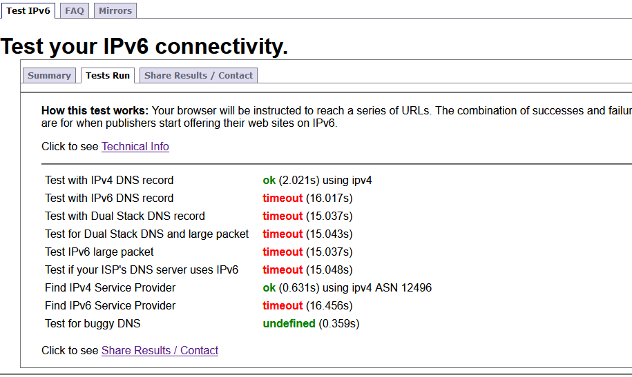

                      @Gertjan You're right - I'd love to see those!
                      This is what I get:
                      2023-06-15 19_52_31-Test your IPv6. โ€” Mozilla Firefox.png 2023-06-15 19_52_43-Test your IPv6. โ€” Mozilla Firefox.png 2023-06-15 19_52_56-Test your IPv6. โ€” Mozilla Firefox.png
                      If I I try one of the URLs which times out (e.g. the vm3 link) as an individual page, it still times out:

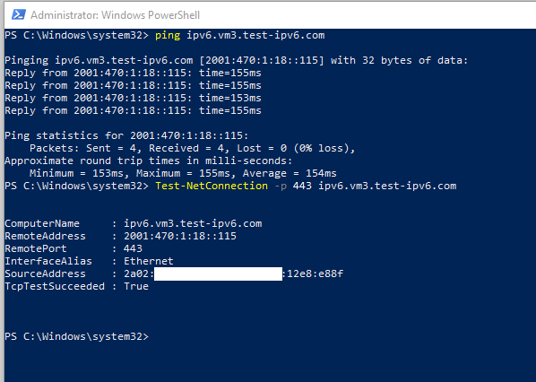

                      If I try a test-netconnection on port 443, it's OK:

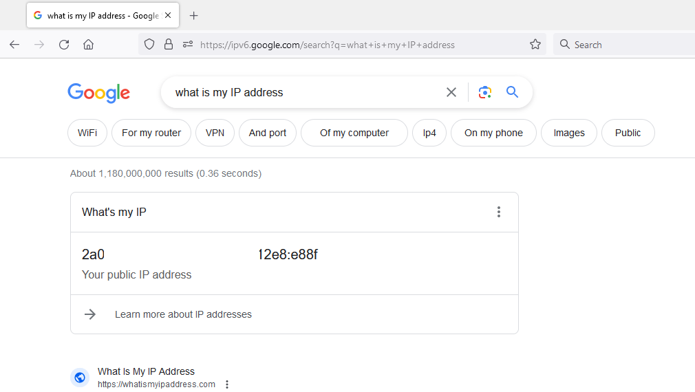

                        @JKnott I get the usual Google page with ipv6.google.com. If I ask it what my IP is, it responds:
                        2023-06-15 19_50_19-what is my IP address - Google Search โ€” Mozilla Firefox.png

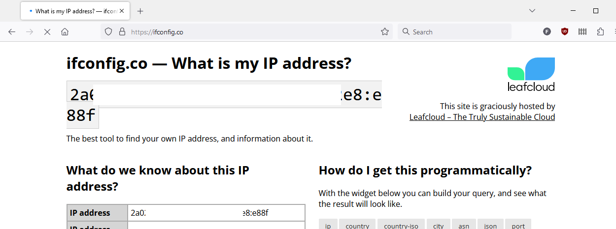

                        If I go to ifconfig.co, it tells me the same:
                        2023-06-15 19_49_50-What is my IP address_ โ€” ifconfig.co โ€” Mozilla Firefox.png

                          OMG - it was in there!
                          You're using FTTP (I think), but your point about MTU got me thinking....
                          The WAN was set to 1492 by the ISP. The LAN defaulted to 1500. I changed this to 1492 et voila!
                          THANK YOU SO MUCH!
                          @JKnott @johnpoz @Gertjan Thank you for jumping in and helping. It was the MTU size which was killing packets... I finally got there!

                            No problem at all. It does not matter if you are on FTTP or not, the physical link on the WAN to your ADSL/VDSL2/G.fast modem should be 1508 MTU, allowing a normal 1500 MTU to traverse wearing the 8-byte PPPoE wrapper (ie as per my settings).
