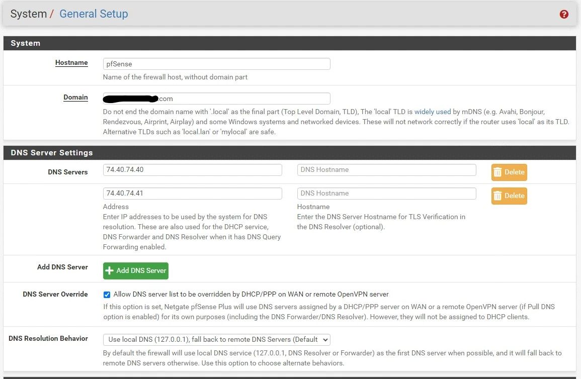

      DNS Settings at the time were as below. Anything cut off in the resolver option screen is disabled. Of note, I thought I had had the python module enabled, and when I restored the previous saved backup (after I resolved the main issue by enabling DNS forwarding in the resolver) the python module was enabled. I'm not sure how or when that became disabled.

      Finally I had the idea of manually setting the DNS server on the client (used Google DNS servers) and that worked (but found I could not access my pfsense on the client). Seeing that, and being reminded now of how the resolver works, I enabled DNS forwarding in the resolver and reset the client to automatic config and that has worked. As noted above, I did then restore a previous backup (mainly to prove to myself that the python module had been enabled) and made the necessary changes to keep things working.

          Btw : consider using pfSense as it was meant to be used :
          So : no DNS servers - no DNS "ISP" override - and Use local DNS (127.0.0.1) .....
          The image of the Resolver settings you've showed above is ok - for myself, I also activated Python mode.
          This is the other, bottom part :
          With these settings, pfSense handles DNS in resolver mode, the "how Internet was meant to be used" mode.
