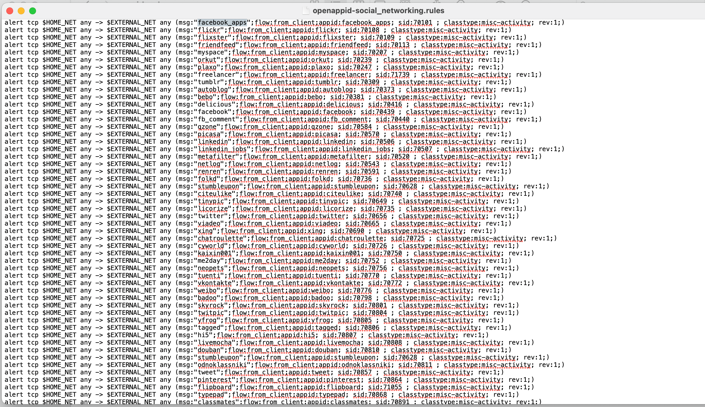

                      • JonathanLeeJ Offline
                        JonathanLee @bmeeks
                        @bmeeks I got this document a couple years ago. Is this useful to you? its from Sourcefire

                            @bmeeks Thanks for the information I appreciate you,
                            I know when we were training on the Palo Alto firewalls at Sierra College the Professor had play with Palo Alto's version called appID detect. Again the school had a paid student licence so we could use all the good rules. They had options like Facebook base and others you could enable to block if you needed. I am just confused does Snort if it is missing the rule for a unknown id? The text rule that is maintained by pfSense has many useable items.
                            (Files from pfSense maintained text file)
                            (New example of the Facebook reference)
                            We actually were training on that old GUI version of pfSense most of it is the same as the new one. We also worked with the new one during a project.

                                @bmeeks I created a list that matches the current rule stub.
                                Attached here. It works with custom area.
                                Sorcerer's code file -->> textrules2.txt
