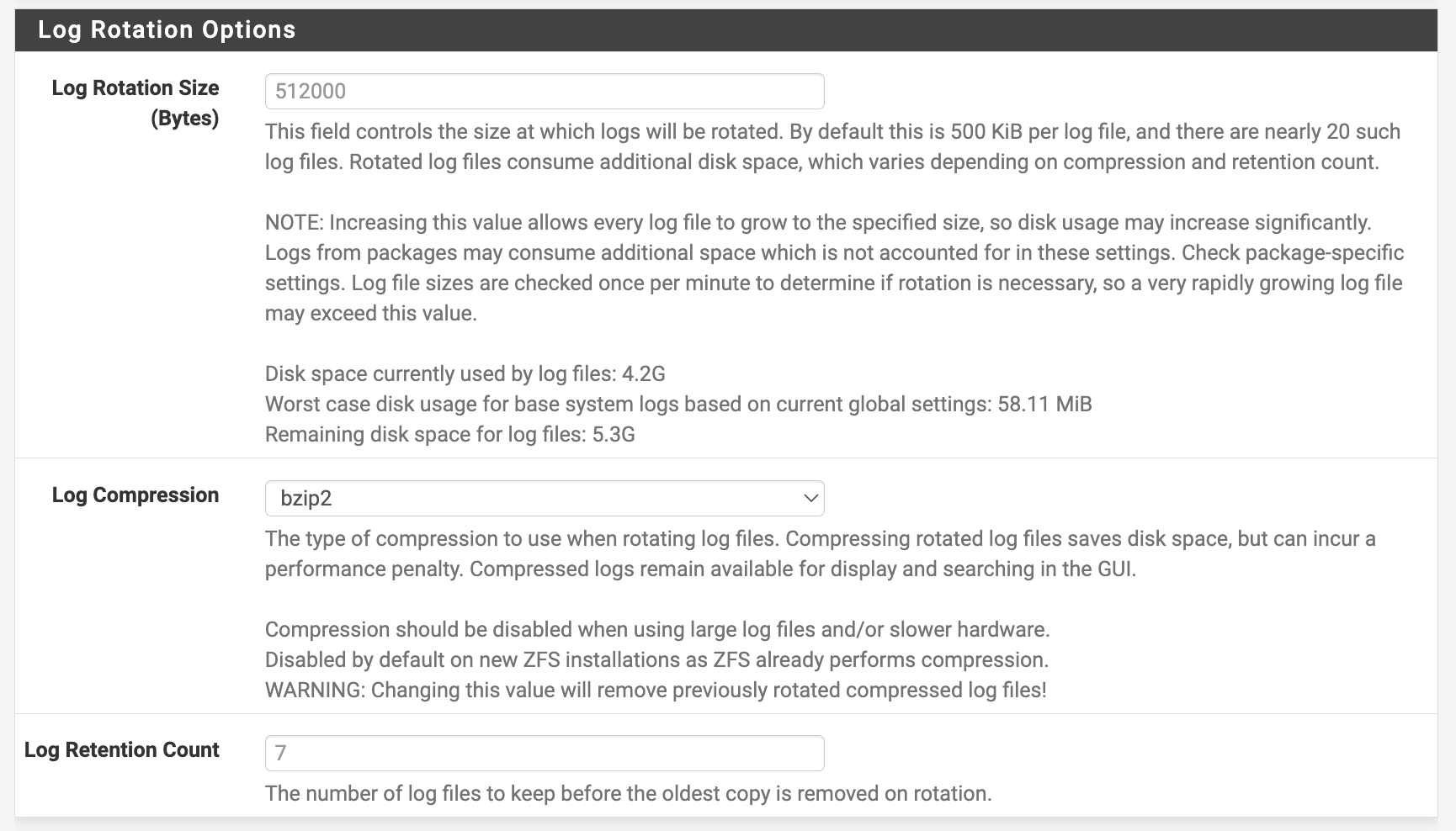

          Then look at Status > System Logs, Settings tab and check the Log Rotation Options section. What exactly is set in the three options in that section?
          See below - note that the values in the first and third boxes are in grey (probably indicating the default values for those fields)

            • jimpJ Offline
              I suspect there is a bug in there similar to https://redmine.pfsense.org/issues/14283 where it isn't doing rotation because the log settings are empty (all at defaults and the entire section is missing from the config.xml file).
              If you make some non-default change to the log settings, such as changing the compression to 'none' (which is probably a good move anyhow), that should kick it in.
